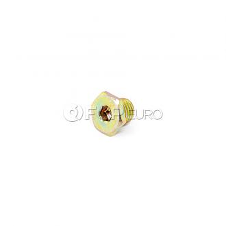

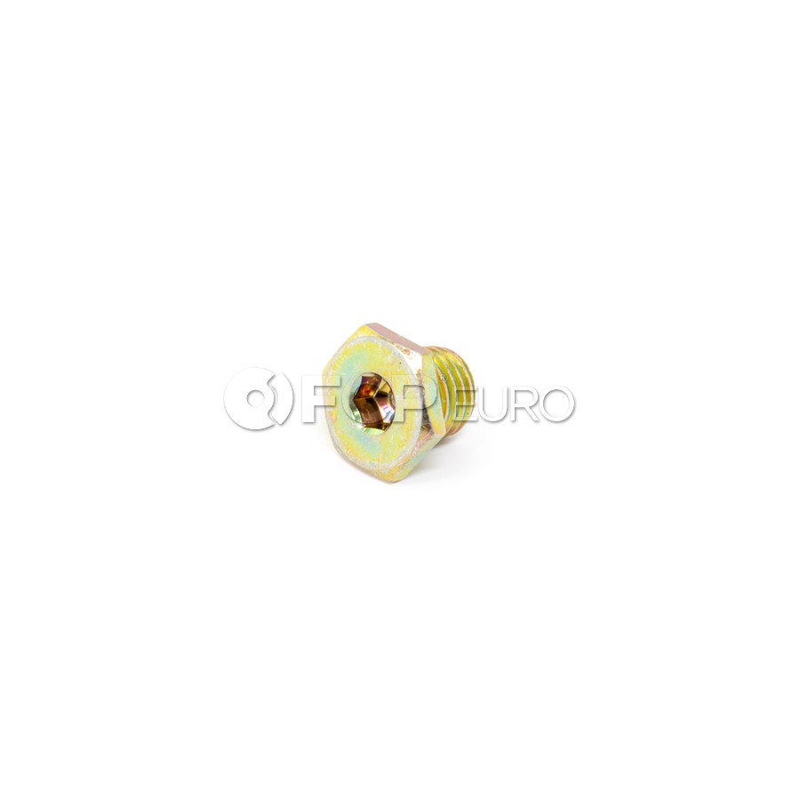

    Is there one available that isn't hex/allen?
    There is the 540i drain plug which has a hex and socket. RealOEM says that it is the same M12X1.5. The stock one is not an issue though if you get a new one and use a good hex bit.

      https://www.fcpeuro.com/products/bmw...-11131742994oe

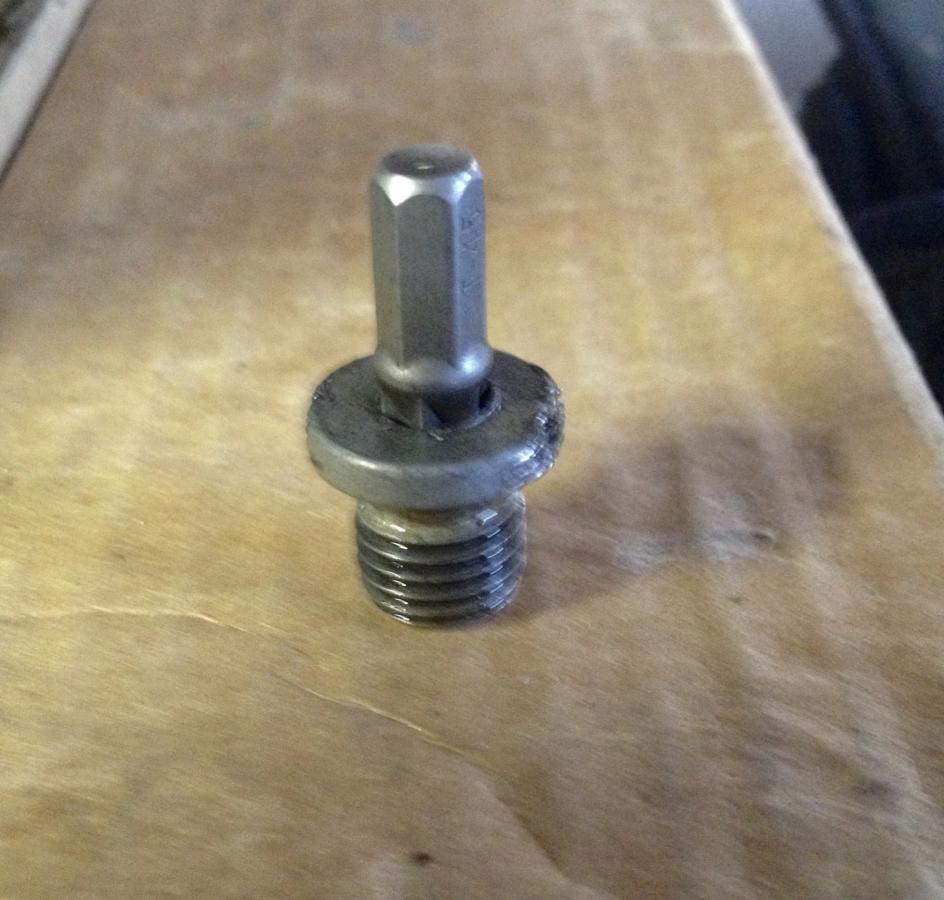

                          If you have access tap a T-45 and it’ll lock in and you can then remove it.
