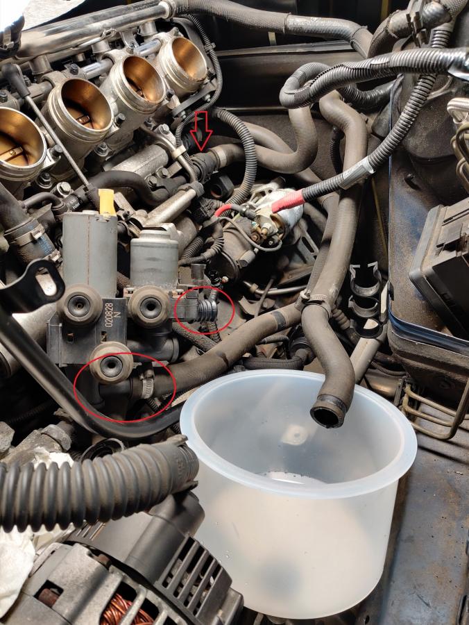

              First disconnect hose #2 (in the link bmwfnatic posted) from the auxiliary water pump, this will drain coolant from the right hand side (when viewed from front of car) of the heater core. Then, separate the quick-disconnect heater core hose from the rear of the motor that connects to the other side/left side of the heater core (part number 5 - here is a visual). You can use compressed air in the end of hose #5 to force the coolant through the heater core and out the end of hose #2 that used to be connected to the auxiliary water pump.
              This picture is basically what I just described but the quick disconnect on hose #5 isn't yet disconnected (red arrow).
