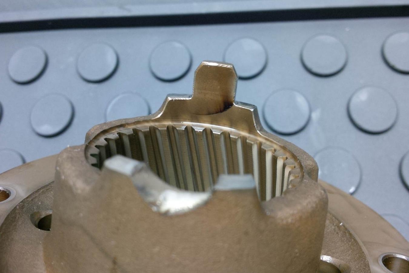

                      I posted a similar picture of my hub on the old forum (I'll need to dig through my photos at home). One tab broke off, the other was partially cracked.
                      I think terra had a partially cracked tab on his hub too.
                      IMO if using an old hub, it needs to be removed and tested with either dye or magnaflux. Oil got wicked in the crack in my hub so it was easy to see, but better safe than sorry. Again, just my opinion.
                      OK, I found the pictures of my hub.
                      The reason I suggest having the hubs removed for inspection is the crack was only visible on the inside part of the tab, which is hard to see when the hub is in place. IIRC, the outside part of the tab appeared to be OK (I'll need to dig deeper in the archives to see if I have a pic of that).
