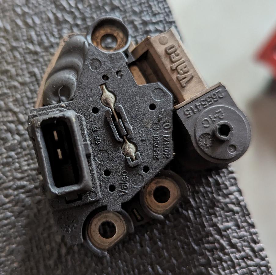

    I was curious so i opened up my Bosch alternator to see what type of regulator was used.
    To my surprise, it is actually a VALEO alternator refurbished by BOSCH.
    It had a Valeo voltage regulator on there.
    Ordered a replacement. For anyone that need a replacement Valeo Part number for the Voltage regulator is 593423.

      I think that's evidence that Bosch does NOT replace the regulator on a reman.

                  Very possible but I've seen newish remans with obviously old or damaged brushes which are part of the regulator. So I very highly doubt that Bosch replaces the regulator. I'd at least remove and inspect the regulator before installing a reman alternator. It takes 5 minutes and will save you time, hassle, and a battery.

                        The brushes are part of the voltage regulator.

                            To confirm: The brushes are in the regulator, soldered in via a wire lead, but very easy to get to. They can be replaced with a bit of a bother, for a fraction of the cost of a complete regulator. Since they wear out over time they are the most likely cause of a voltage problem on high mileage cars.
                            in retrospect, if you’ve still got an original alternator on an e46…and don’t want to risk loss of your vehicle for a few days or more when your alternator fails…just buy brushes and have a high temp soldering iron/solder. The repair is probably a 5 minute job once the alternator is on the bench.
                              A voltage regulator is less than $100. I’d rather do that than mess with soldering brushes on…and you should also replace the springs on the brushes.

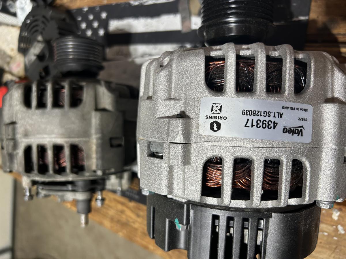

                                For those of you that want to buy new, complete alternators, as of the time of this posting:
                                1. FCP Euro doesn’t have the Valeo, they lost it NLA. But they do have Genuine BMW reman for $550
                                2. Bimmerworld carries the Valeo in their catalog but doesn’t indicate “In Stock”
                                3. ECS Tuning has the Valeo in stock for $395
                                4. Amazon merchants, AutoZone, etc. have the Valeo 439317 for about $290. It’s a new one, no core charge.
