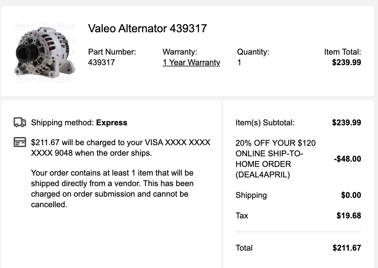

      No joke I got it at Autozone with a $50 off promotional coupon via the Honey chrome extension. Had to call to verify 100% that the unit was indeed BNIB and was not let down when I got it. Just checked and I paid $211 with tax to my door lol.
      Just google Valeo 43917 and go with whoever has the cheapest price atm.

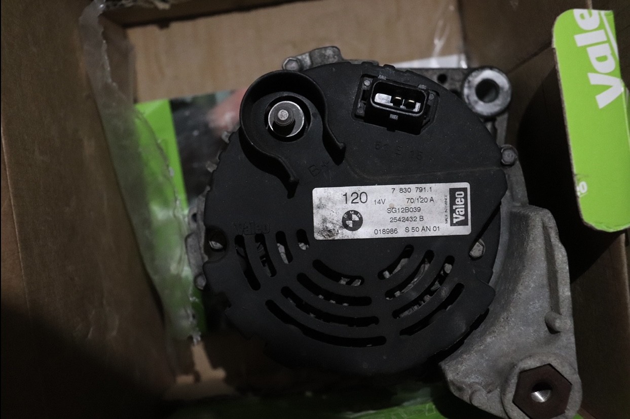

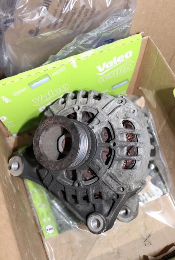

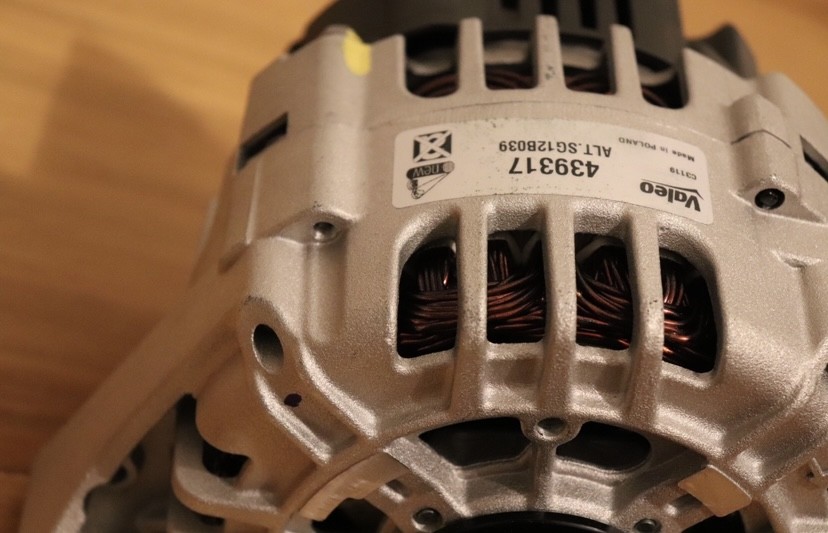

                As per others can vouch for a new Valeo unit.
                I usually only use Genuine BMW parts on my car but for this job I would advise against this. Iirc I paid ~£250 for a new Valeo alternator from ECS Tuning in 2019 (incl import tax as I live in the UK), but BMW wanted £600 for a new genuine unit.
                The units are made by Valeo (not Bosch) and so I could not justify paying an extra £350 for a BMW stamp on the part (which you cannot see once it’s installed). The previous unit lasted 17 years / ~85,000 miles. The Valeo unit I replaced is now 3 years old covering ~30,000 miles, still going strong and I expect it to last as long as the original unit. (Never bothered to check the voltage as the voltage on the old unit was practically nil).
