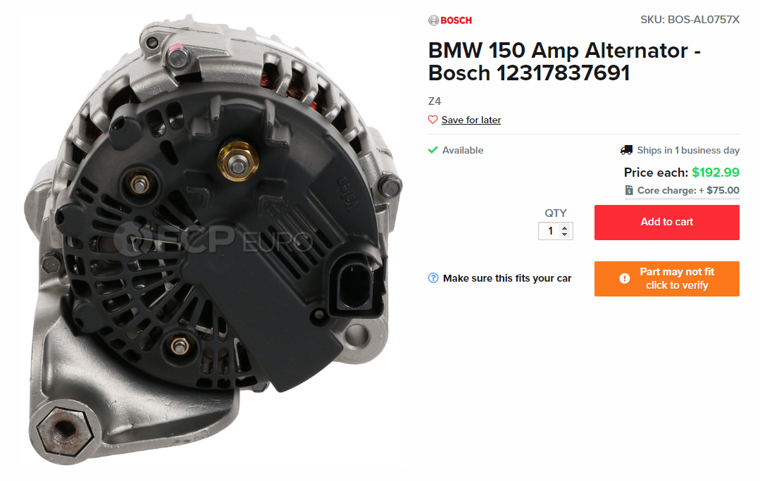

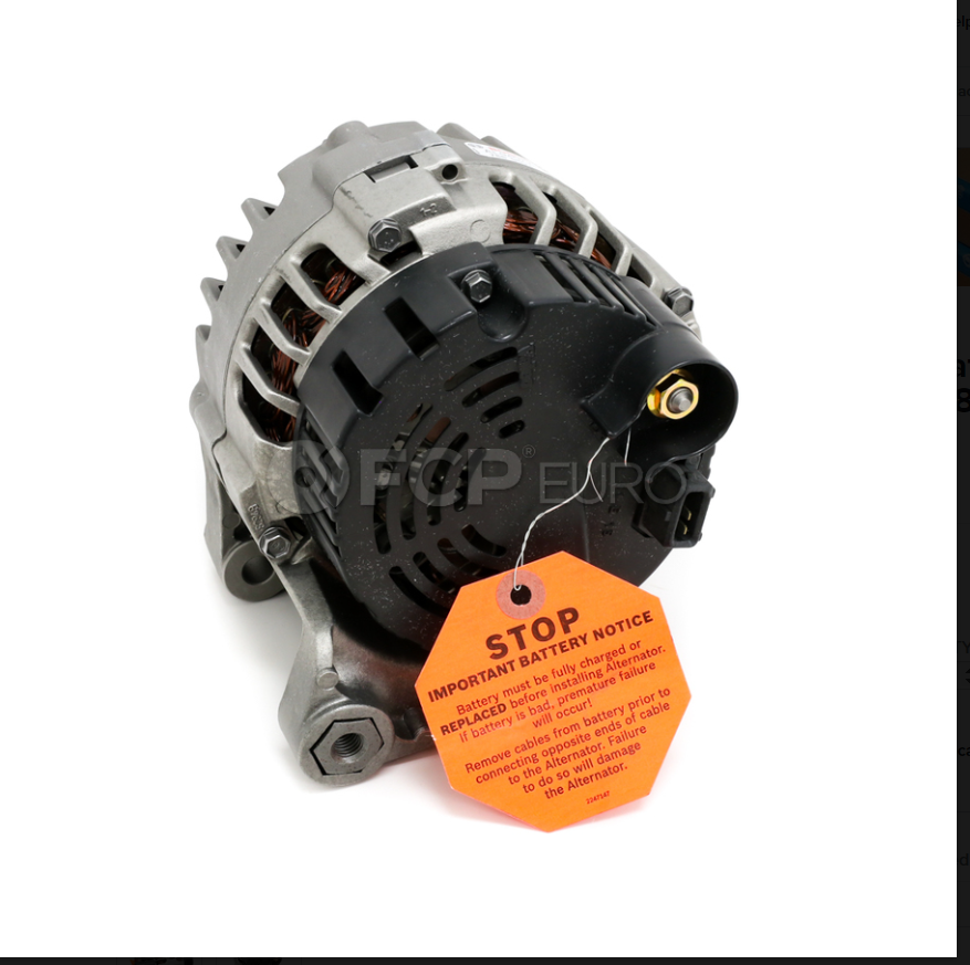

                          Doing a little digging it seems like the plugs on the back are slightly different. I believe you can just swap plugs but would need confirmation with someone who has done it already. I did end up ordering the 140a X5 alternator last night so we'll see what happens when it comes in tomorrow.
                          Pics of 120a (OEM e46 m3 alternator) vs the 150a (OEM z4m alternator)
                          Click image for larger version  Name:	e46m3 120a alternator.png Views:	0 Size:	489.0 KB ID:	186175
                          Click image for larger version  Name:	z4m 150a alternator.png Views:	0 Size:	519.5 KB ID:	186177

                            #43
                            Looks like the electrical plug is different.
                                Thanks for doing this. Looking forward to the results.
