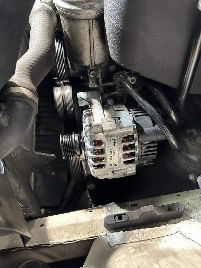

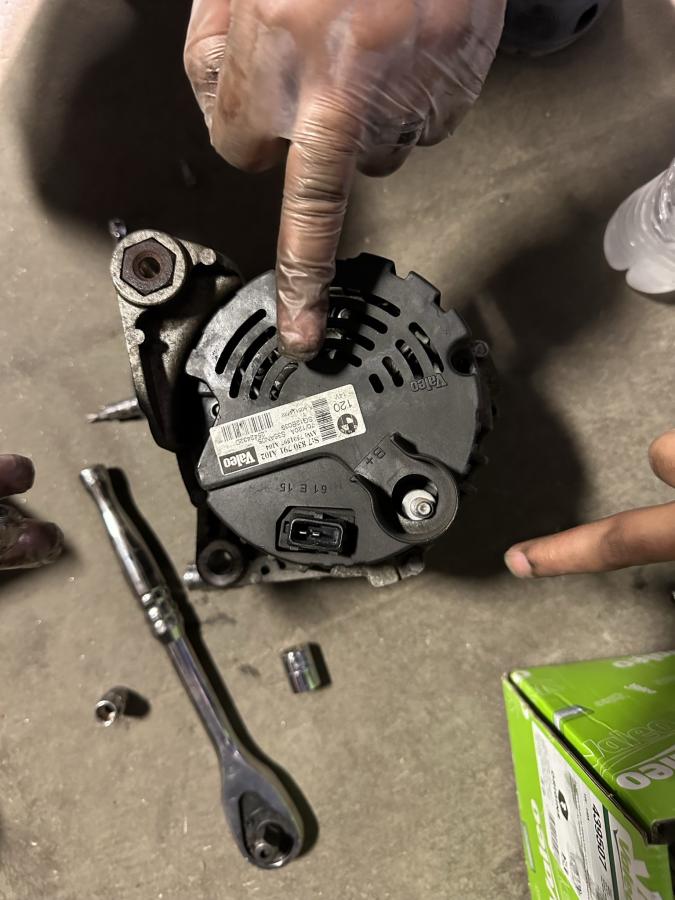

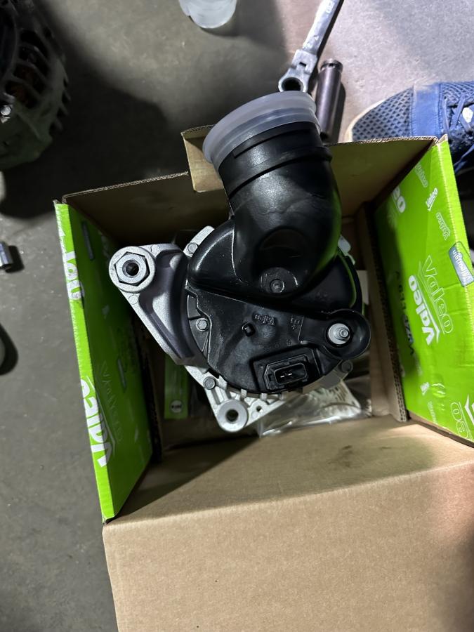

                      So finally was able to tackle the x5 140a alternator install tonight with some help from a couple of buddies. Great news... It bolts right up! All you have to do is swap the back covers and you are good to go!! this seems like a great alternative.
                      bigjae46
                      0-60motorsports
                      PSUEng
                      D-O
                      Here are some pictures
                      This is the new 140a X5 alternator. As you can see there is a port for cooling
                      Back of the OEM 120a alternator
                      X5 alternator inside the engine bay with the e46 rear cover on.

                        Thats Awesome! Thanks for trying it out. I might go this route in the future.
                          #57
                          But then no cooling port?
                            #58
                            There is no cooling port on the Z4M 150amp alternator either. So this should be fine.
                              #59
                              Also no cooling port on the OEM 120a either because the power steering lines are in the way.
