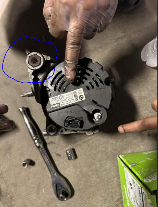

            Great find for second source!
            Hint for ease of alternator removal: use a socket as spacer around the colored nut and use one of the alternator bolt to pull the nut rearward to free it from the oil filter housing bracket, then it can be lifted out easily. Don't tap on the front bolt using hammer to move the nut rearward as this could dent the radiator or crack the alternator ear where the nut is embedded.
              That's a great tip. I've also learned (the hard way) that tapping on the alternator casing can unalign both halves of the alternator casing and cause the bearings to bind. So yeah don't tap it when installing or uninstalling.

                          Anyone aware of how to read Valeo date code? This is what I pulled. I assume since the BMW logo is on it that it was original to the car.
                            #73
                            Valeo is a french company so I'm assuming S = semaine (week). An is year. So 26th week of 2004.
                              #74
                              Wow, 4 years of french and I would have never made that connection. Thanks!
                                #75
                                My old one from my 08/2004 build car is marked S29AN04 so that would appear to line up.
