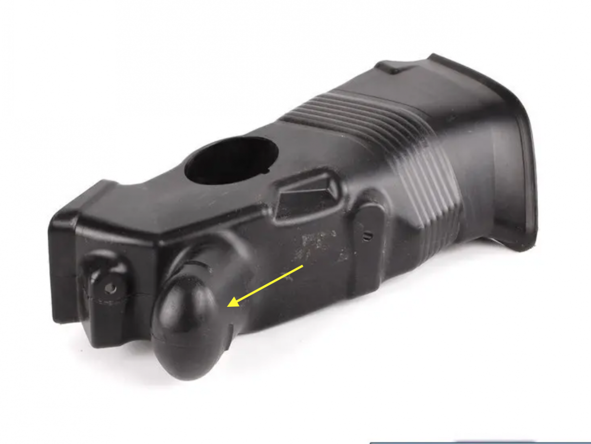

    ok, I think some non-Ms had a cooling duct from the foglight area. Might have been ZHPs or something. Or maybe auto cars.
    Funny enough, the M3 has a molded intake port on the brake duct that has been blocked off. That could have been for alternator ducting.

        Click image for larger version  Name:	Screen Shot 2023-06-18 at 10.48.26 PM.png Views:	0 Size:	637.2 KB ID:	222386

          ...That might actually be that mystery solved. I always wondered what that was for. Sure looks like the alternator ducting would fit there
            The problem might be the oil cooler lines it might interfere with the duction maybe not.
                              That’s exactly what it’s for.
