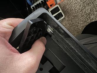

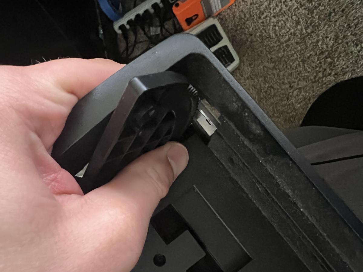

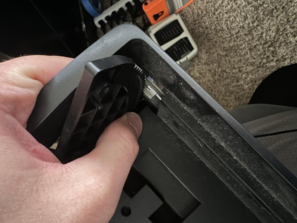

    Seriously struggling with removing the Navigation unit from the interior. I have the keys and know how they work, but cannot find the slots under the knobs. Any tips? I don't have the screen in the "up" position, but I noticed some people on youtube leave it down. Is it easier with the nav in the "up" position? I just hate to plug my battery back in because I have the steering wheel airbag removed and the seats removed.
    Mr. Wolfe
    You want to have the screen in the "ejected" position for sure.
    Here's some pictures of the mechanism you're trying to actuate:
    Resting position:
    Click image for larger version  Name:	IMG_0917.jpg Views:	0 Size:	115.6 KB ID:	178830
    Clip pushed "in" which allows the unit to pop out
    Click image for larger version  Name:	IMG_0918.jpg Views:	0 Size:	91.4 KB ID:	178831
    Side view:
    Click image for larger version  Name:	IMG_0919.jpg Views:	0 Size:	97.0 KB ID:	178832
    So basically you want the keys flat, and then you want to push them inwards.
