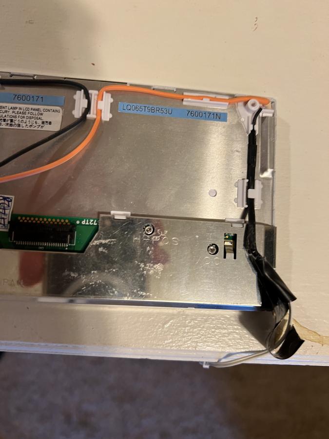

            You have to center the image on the LCD using this trimpot:

            that means you have to assemble the monitor at least enough to get an image on the screen.

                There’s no way to know without turning the monitor on (reassembling the BMBT).
                This means there’s two ways to handle it:
                1. Assemble the screen (and hopefully it’s already centered, but not likely), then disassemble it, adjust and repeat until it’s right. I don’t have the patience for this method.
                2. Assemble the screen enough so the ribbon cables are connected, just the ones for the picture, and hold the assembly in your hand while you use your other hand to adjust the trim pot.
                It is worth noting that the screens seemingly are not way off, maybe 1/8 - 1/2 inches in either direction, so if you’re not too peculiar, you can get away with leaving it as-is.
                Thanks!
                -Ted
