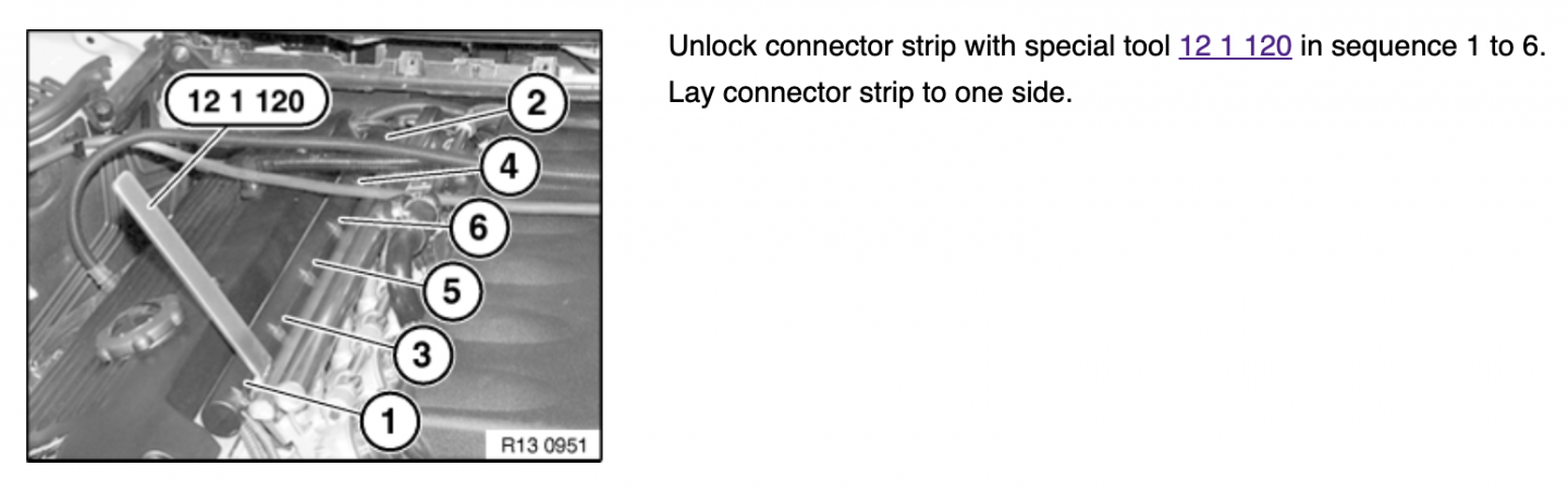

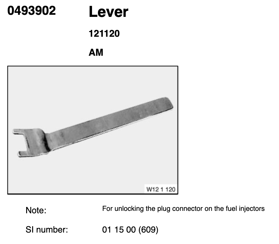

          TIS says you're supposed to use a special tool to pull up on each connector, which looks like it's made to partially move the clip out of the way:

              The injector has a barb which latch to the metal clip, just like some coolant hoses on the non-M engine. Clip must be remove in order to pull the connector off the injector.

                  Was able to salvage the connector and get it to click into place. The injector does have a steep ramp. While technically you can pull the connector off I can see why BMW made a special tool to do this. I was able to pull cyl !-3 off but cyl 4 wouldnt budge and I ended up damaging some of the plastic. It doesn't look pretty but I think it will hold. There is enough mechanical relief from the other connectors that I think this one should be fine 🤞

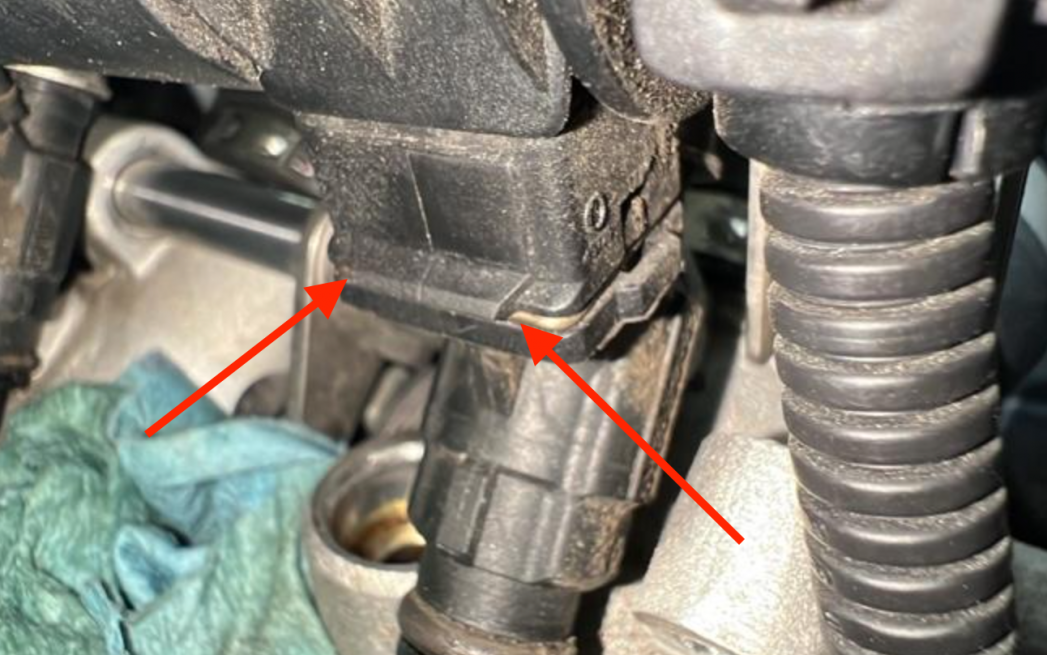

                        I use a right angle pick tool and pull the ends of metal clip back. Its easy to get one side off then just take the pressure off the other side as you pull up.

                              i had a hell of a time doing this the other day. ended up using a small pick to lift one side of the metal clips up and over the plastic and pulled them out
