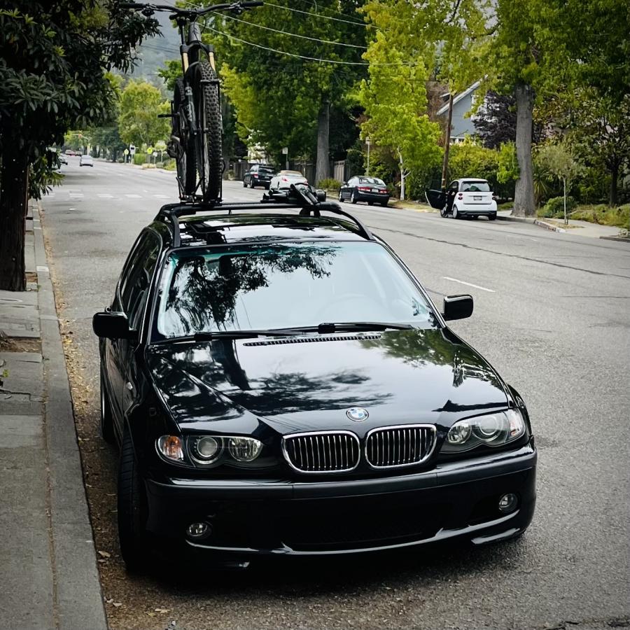

          Last, you mentioned mountain biking. We should meet, check my avatar photo I’m in Berkeley, we can invite Heinz too and scheme up some good projects..

            Hell yeah! I don't currently ride mountain but want to get back into it soon.
