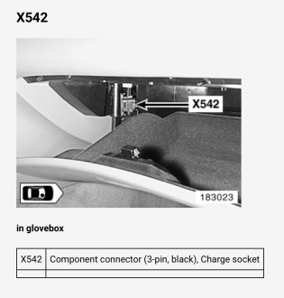

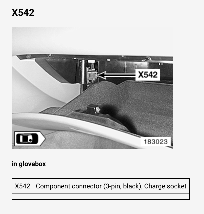

      Also - the socket is labeled as connector X542 and I've attached the wiring diagram below.
      It's connected to the General Control Unit A1 via connector X254 (Pin 22). (labelled as "Charge Socket" on the second diagram).

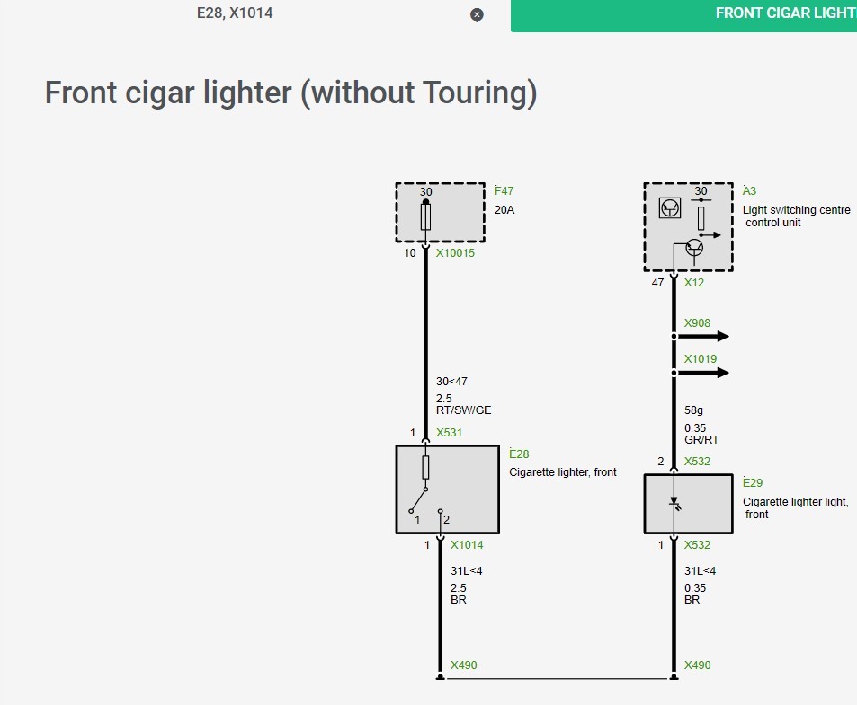

                  Just to clarify, Pin 22 does NOT drive the actual cigarette lighter socket. It drives the illumination of the cigarette lighter socket. Two different things.
