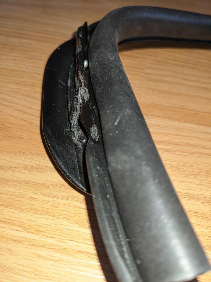

Let me know how it goes, I can add it to the first post for others to see!Originally posted by 6MTGirl View PostThis is the AmeriSeal multi-purpose bulb seal. I did heat it up for a few minutes with a blowdryer beforehand. It seems to fit really awkward around the rail at the end, but I don't know if I can get it to sit any flusher without damaging the rubber.

Post some pics after its installed, will be doing this too on my end.Originally posted by 6MTGirl View PostThis is the AmeriSeal multi-purpose bulb seal. I did heat it up for a few minutes with a blowdryer beforehand. It seems to fit really awkward around the rail at the end, but I don't know if I can get it to sit any flusher without damaging the rubber.

that looks really good. no kinking at all. which tubing did u purchase?

I'm in the middle of replacing the weatherstripping - can someone take a look at these pictures and tell me if I've done it right? I'm waiting on the quarter window horizontal trim, so I haven't attempted reinstalling the side finishers yet. My weatherstripping didn't kink and I didn't use any plastic tubing. I've been reading comments about getting a perfect "bulge" with the tubing, so at this point I'm wondering if this will fit or seal right since I didn't use any. I did trim the spine around the screw holes everywhere except the last two screw holes where the rail is. Does this sound right?
