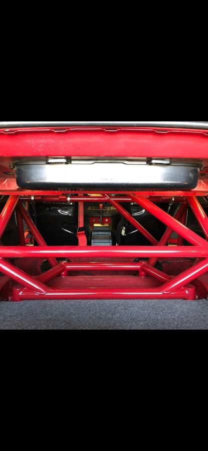

    Wondering if anyone is running a 6 point RACP brace in their E46? I already have reinforcement plates however I am looking to bullet proof the rear end as I plan to go turbo in the future. This seems like the most cost effective and simplest to install. Is this a solid long term solution?
    Definitely, and increases rigidity for our weaker b-pillar-less coupes. I have the rear portion of that, and probably will only bother adding front cups, but that 6 point bracing is solid - even better tied into a full or half cage for off-road (no I don't mean dirt) use.
      I"ll be running them soon. That particular pic has equipment that has been copied from the original www.yurkancages.com , me and a bunch of from my car group are looking to make an order in the off season.

        Yea I found that picture on eBay and it seemed a little sketchy, glad to know who the original manufacturer is. What do they go for shipped to the US? Would def be interested in a group order!

            Last I spoke with the owner it was 499EUR for the YC46W5 variant that would allow for the rear seats to fold down. That was last year and prices due to material supply may have swayed that. I'm torn between that and the more rigid YC46X.

                  Weird, been thinking about this subject the last few days. The 6 point brace is going to do quite a bit for rigidity in addition to reinforcing the failure points. I wonder how something like this would compare to a 4 point bar like the PureTech paired with Vince bar gusset cups. I feel like if you don't care about the car looking 100% original, there are 6-point braces that allows use of the rear seats, or the ones that doesn't fit with rear seats are probably a little more rigid since the bars can be placed in the most efficient areas.

                    Im building something more akin to a GTS rather than CSL, rear seats will be deleted for this install. The cage is about 7.2kg with the rear seats gone and a nice seat delete panel for sound insulation i think the weight effect will be net negative.
                    With it i can also run a coil over rear setup. I'm excited to install it as soon as the glaciers melt here in Canada.
                    In the order i made, a track buddy installed the W5 variant that allows for rear seats fyi

                            I have the full cmp underside & topside reinforcement kit, solid subframe raising bushings & 6 point brace. Most definitely makes the rear end noticeably tighter and stiffer. I have retained my rear seats with the brace. It does not interfere with them at all.
