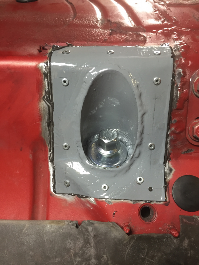

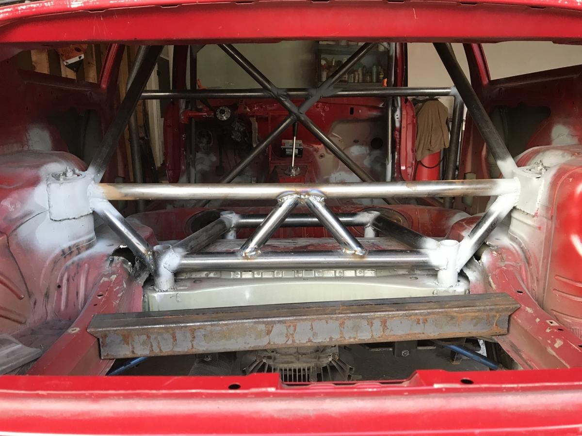

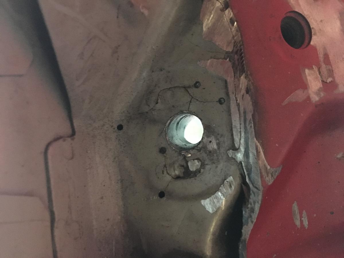

    I custom made a structure in 2017. I also drilled out the holes where the subframe bolts threaded into and use a 1/2" grade 8 bolt which bolts the structure and rar subframe to the floor. The bolts are torqued to 120 ft/lbs.

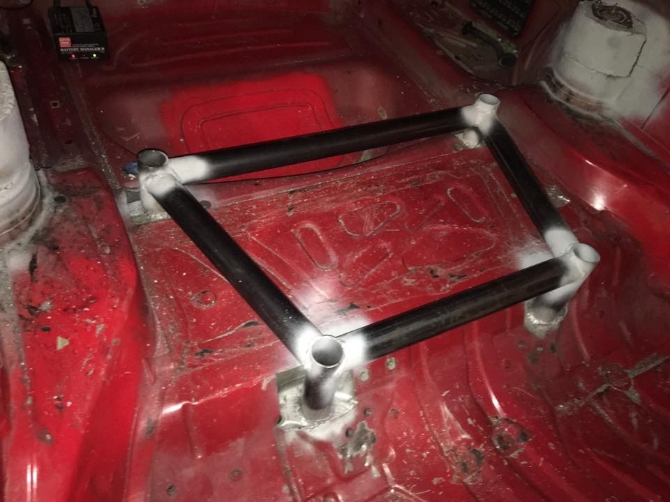

    I did make a mistake...I should have tacked the assembly and then welded it the structure outside of the car. Welding would have not been such a massive challenge...and also would look a lot better
    Then I tied it onto the strut towers and roll cage. There's also two bars that go from the two front mounts to a bar between the main hoop and rear bars. So all 4 corners are tied into something else.

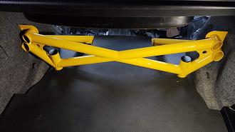

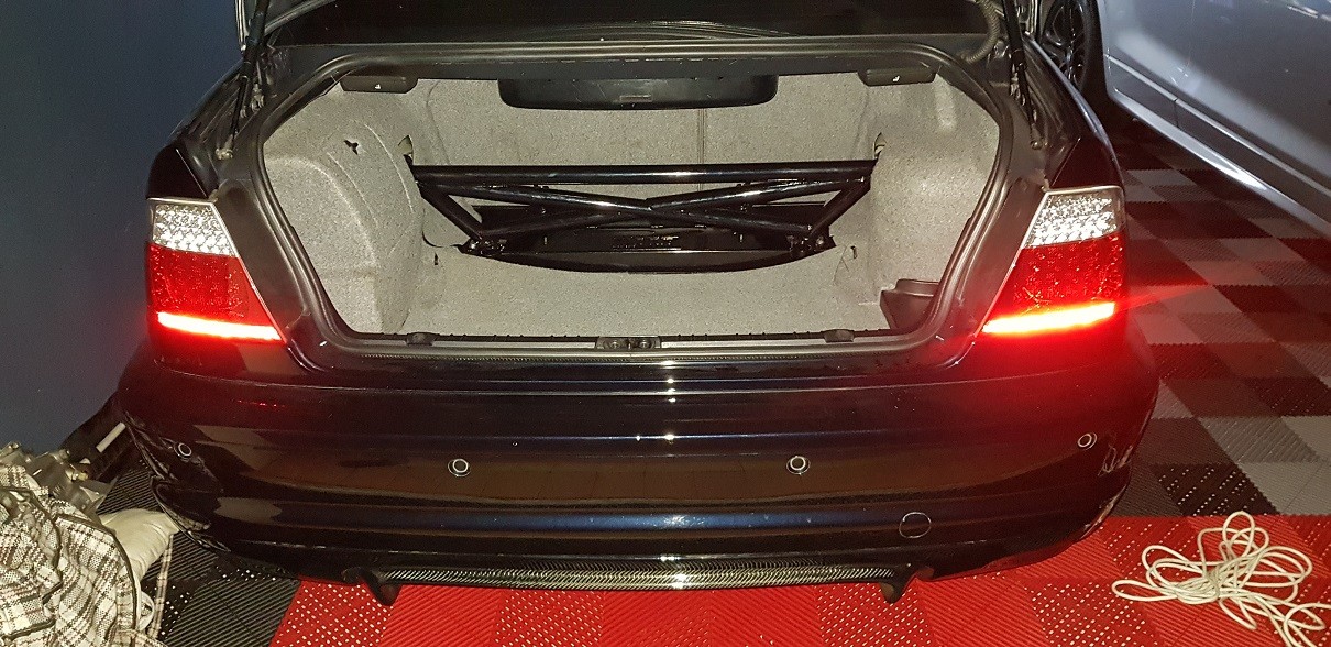

      I have the full cmp underside & topside reinforcement kit, solid subframe raising bushings & 6 point brace. Most definitely makes the rear end noticeably tighter and stiffer. I have retained my rear seats with the brace. It does not interfere with them at all.
      Do you have some pictures? I'm trying to imagine a CMP topside setup and a 6-point brace together
      '01 M3, Imola/black
        Only pics I have. Boot trim needs to be tidied up but you get the idea

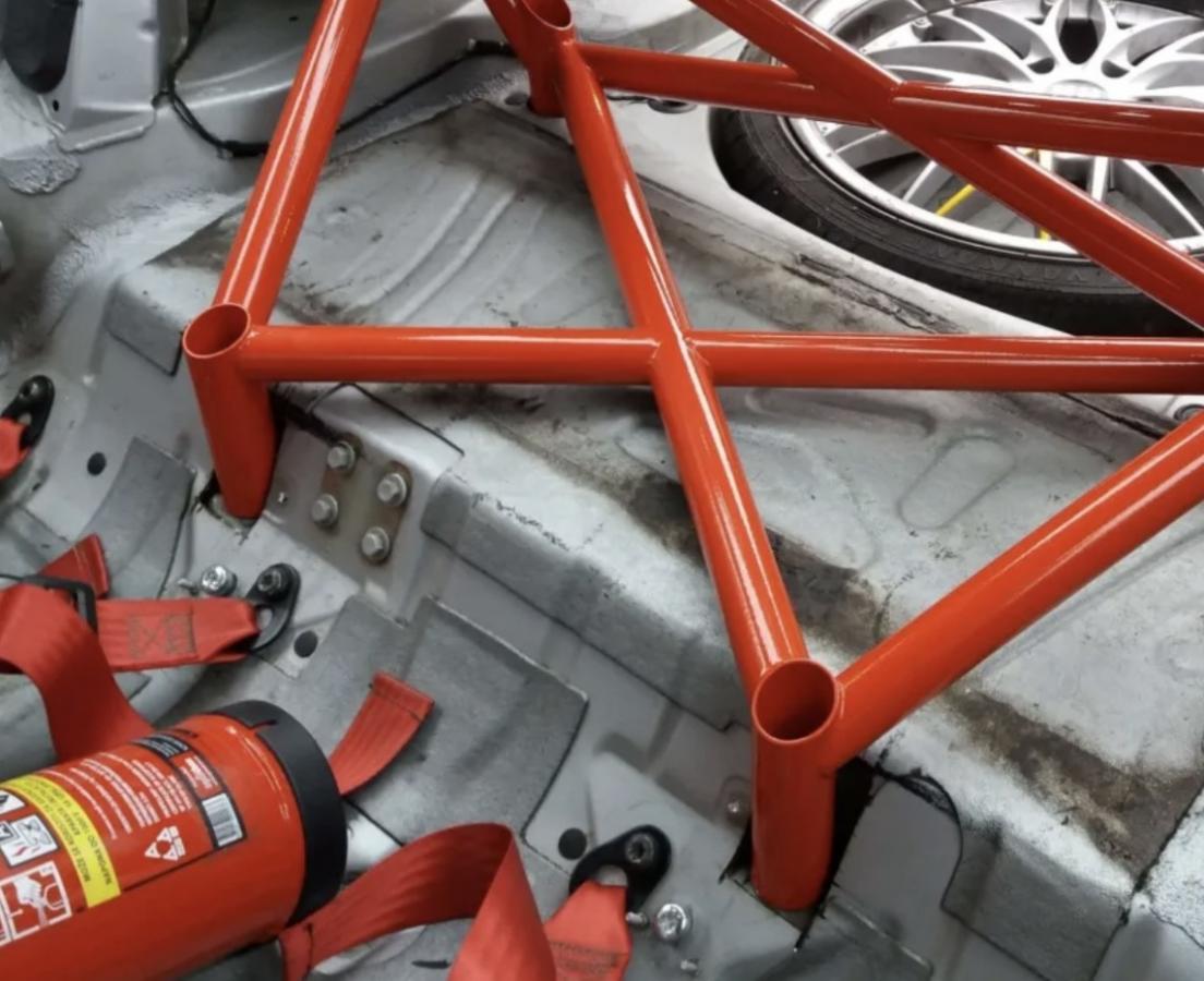

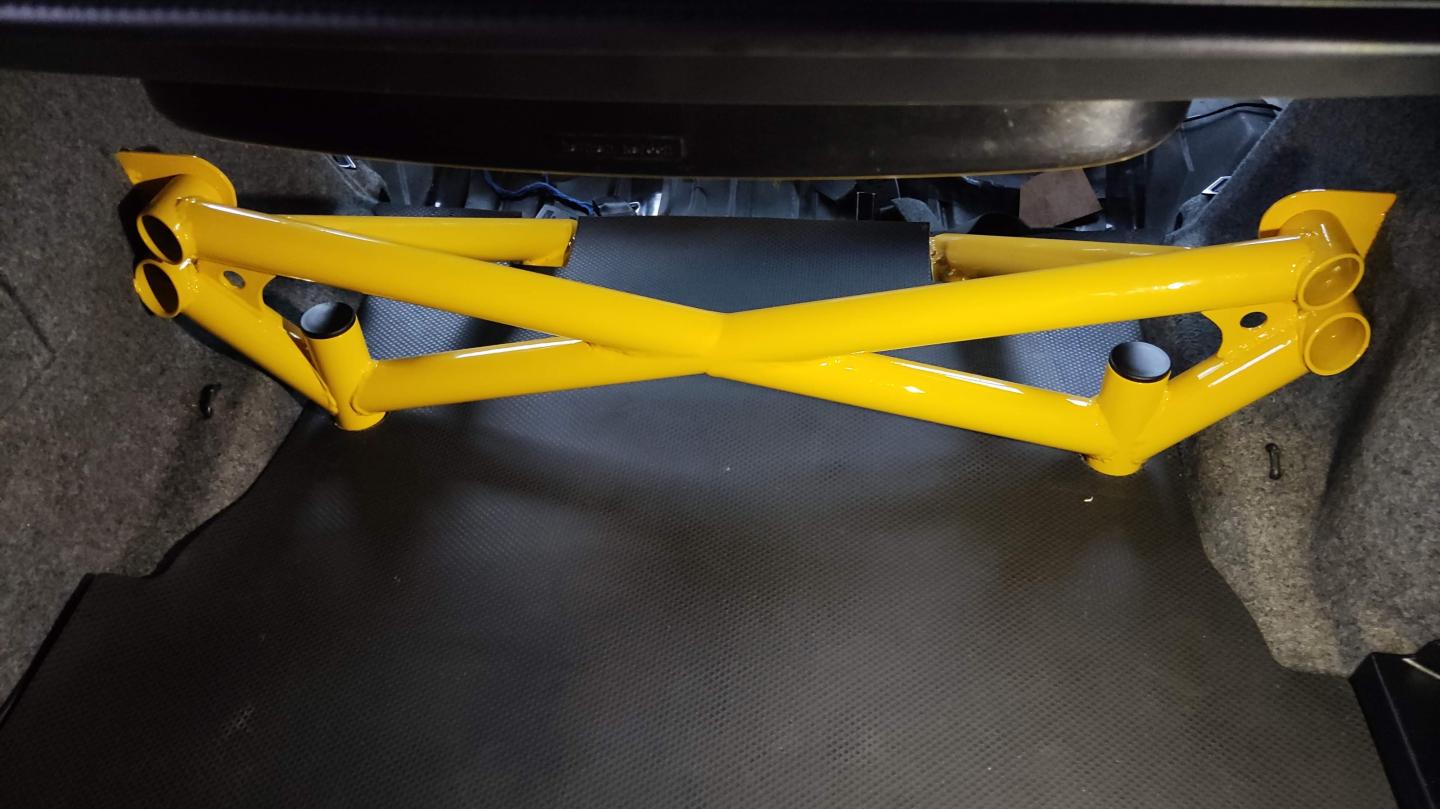

          Made my own a few years back, I liked the look of the Puretech so copied the style for the X brace section.
            Cool, do you feel like that's a little redundant though?
            '01 M3, Imola/black
              Not really tbh. At the time, my racp was cracked pretty bad so I thought I may as well go the whole 9 yards with reinforcement

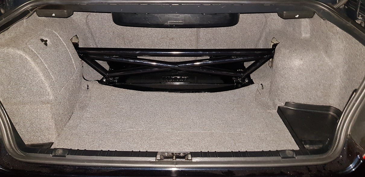

                          I am guessing from eyeballing it, this style brace would not fit either with the gusset cups:
