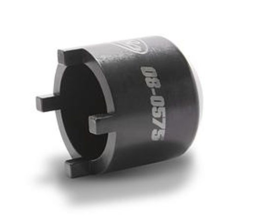

    1. Looks like you need a pin wrench or a socket with four protrusions on it, like what's used sometimes for axle nuts. Did a quick search and apparently they're called spanner nut sockets? Could be wrong though. Anyway they look like this:
    Click image for larger version  Name:	Screen Shot 2022-09-16 at 3.28.27 PM.png Views:	0 Size:	84.1 KB ID:	184810
    If you just want to take it apart and don't care about destroying the nut, a cold chisel/flathead screwdriver and a hammer should get it off quickly.

      Does anyone know what tool is needed to remove these rings?
      Spanner nut socket as said, or modify a standard socket with sanding wheel.

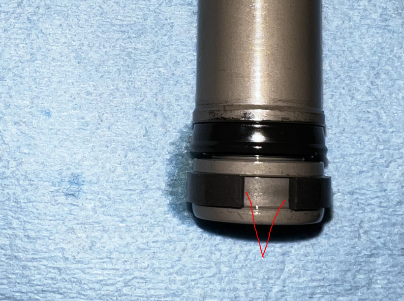

        More teardown photos posted to the google drive link. Anyone with experience in hydraulic seals know the type of seal this is?
          Is the seal in pic broken or it is normal?
            its normal. its a metal spring steel ring. The other seal is some form of rubber and has a taper to it.
