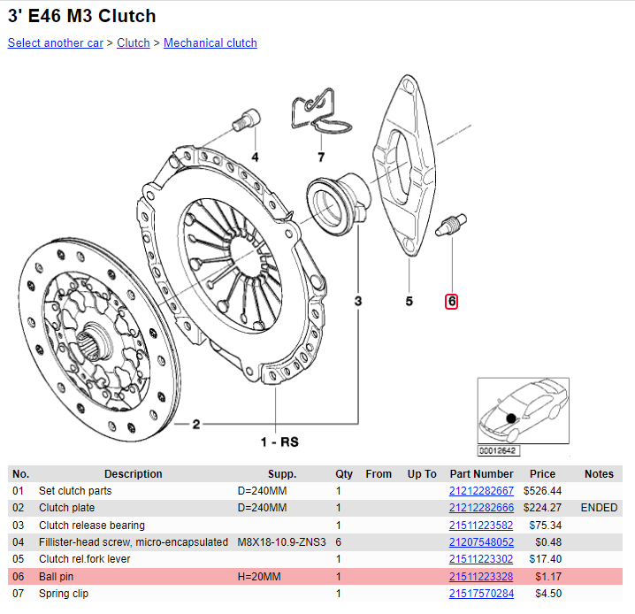

    This sounds like what happened to me and after exhausting every other option I pulled the tranny to find that:
    (1) The plastic pivot pin (#6) had snapped which meant the fork (#5) was flopping about when it should only be able to pivot forward / back when actuated by the slave cylinder
    (2) The throwout bearing had a pretty nasty crack in it, presumably because of the uneven pressure applied to it due to (1); I drove with the car like this for longer than I care to admit
    (3) The clutch was original at 180k miles and absolutely toast
    Ended up doing the clutch / flywheel and all the surrounding parts while the tranny was out. Also opted for the stainless steel pin BMW offers for other models so that it never happens again.
    See my thread here.
    Click image for larger version  Name:	Capture.png Views:	2 Size:	178.8 KB ID:	185830
        See my thread here.
