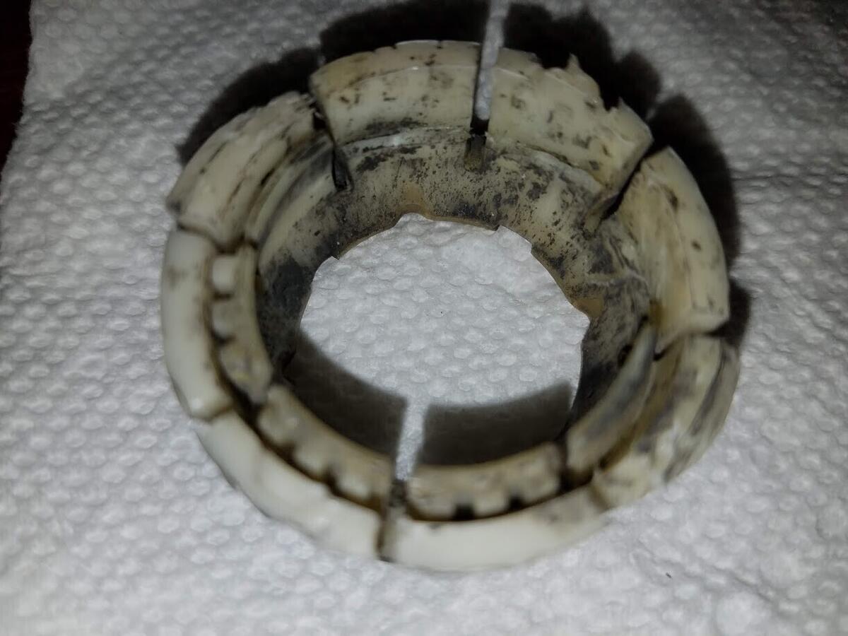

                      You might check for a worn shifter bushing.
                        I think this is sound logic and I don't think you'll get any alternative ideas at this stage. Good luck
                        Thanks! I'm taking pictures and will put together a guide of sorts for inexperienced DIY'ers like myself. Haven't been able to find an M3 specific one yet that isn't a graveyard of dead images.
                        This was actually one of my first stops in troubleshooting this issue, so the shift lever, cup, bushings and pins will all be crispy once this is sorted.
