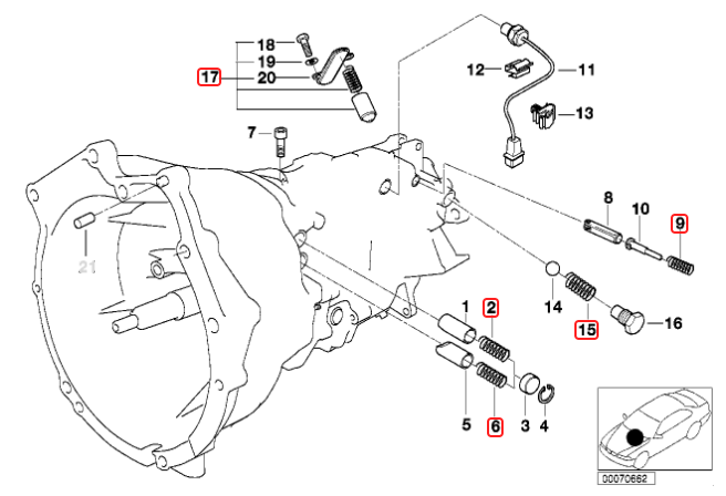

    Based on some searches it seems like SMGs have an issue with compression spring #9, where it will refuse to shift at higher RPMs, or will wait until the RPMs drop. I've basically been forced to drive my car in that fashion as well so I'm wondering if the same issue could be presenting itself in a 6MT.
    I'd give replacing #9 a go, but the diagram seems to be different than the pictures of SMGs I've seen of a press fit plug with the spring behind it.
    How does one actually access this spring on a 6MT? Also could #15 / #17 have anything to do with this issue? My understanding is that #2 / #6 are replaced for centering slop which isn't an issue for me.

      You need to change the #9 spring, it will be broken for sure. I opened 3 transmissions lately, 2 SMG and 1 6mt and all 3 had broken springs. Even on a 53k miles transmission...
      That spring is located behind the #11 sensor. You will need a 22mm wrench to remove the sensor.
      This diagram seems wrong btw. #9 is in the same hole as #11

            When it's hard to shift into 1/3/5 then it means the main shift rod jammed by a broken pin with roller #8, or something jammed the pin from moving in/out such as broken spring #9 bind inside the bushing. All other springs are for detent on the internal shift rod, and if your car is an older model, then it's better to swap out the 3 balls under the springs #17 with the updated sleeves, but don't touch the two fat pins in between those 3 springs/balls.
                I'm sure it will be obvious once I start pulling stuff apart, but where is #17 (and the collective parts) located? It doesn't show it too well on the RealOEM diagram.

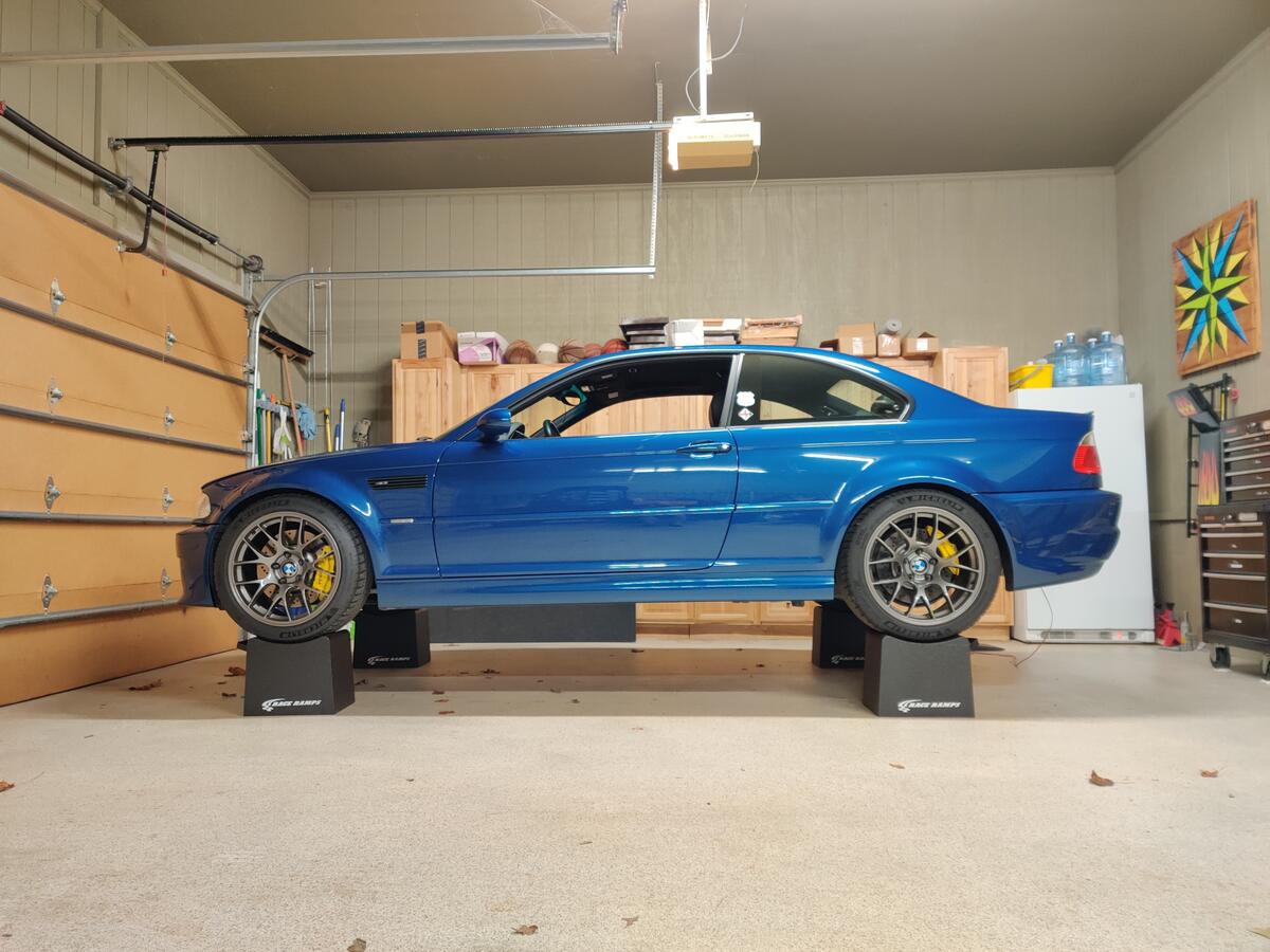

                Edit: first time using these stands. LOVE THEM. For this type of job, only thing better is a lift.

                  Casa,
                  I believe OP has SMG and yours is manual?
                  viewed from rear:
                  #17: these parts are at upper right , rear.
                  #14: upper left, middle, near reverse and GPS switches.
                  There are 4 internal shift rods:
                  R, 1/2, 3/4 are at #17
                  5/6 is at #14 with ball and sprint detent.

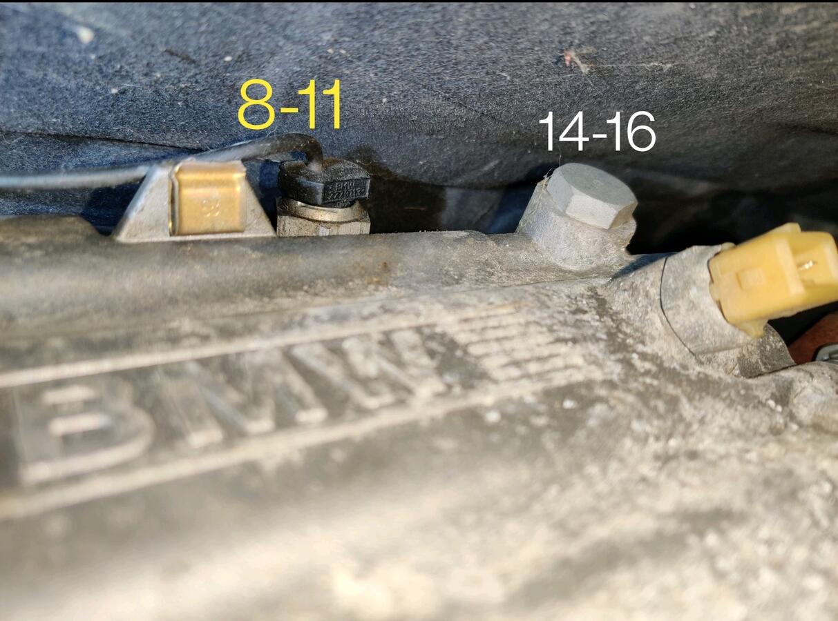

                            Is it possible to remove these driver side springs/detents with the tranny in place? I can get to #14-16 pretty easily but #8-11 look pretty tight. I need to head back to my other shop to pick up tools (22mm wrench), but it looks like #8-11 might have clearance issues against the transmission tunnel once it's loosened.
                            Also, is there anything to worry about once these are out? As in, would pulling these out to inspect cause something else to go haywire? It looks like "no" but have to ask...
                            Lastly, #17 appears like the tranny has to come out to get to...

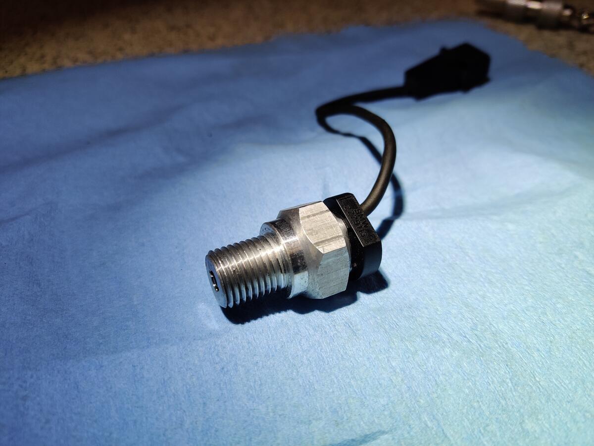

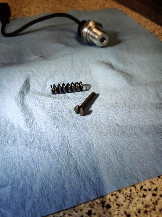

                              Answered my own question. Got #8-11 out, super easy to do. It was barely tight for a 22mm and then easily hand spun out. Going in to get the spring a detent next.
