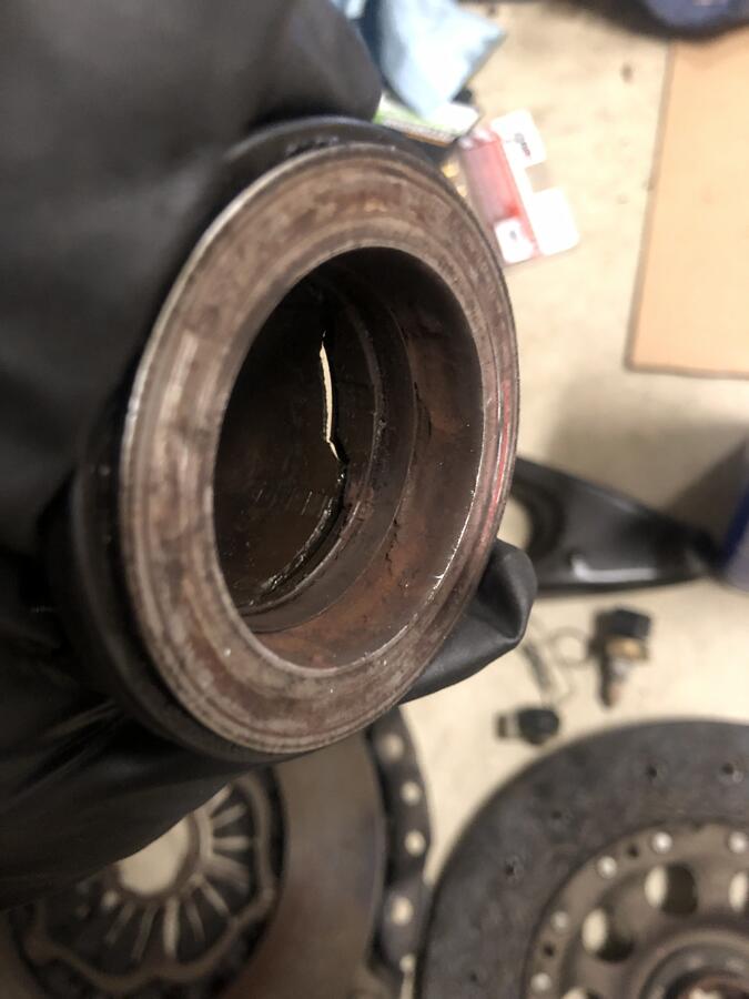

    Originally posted by dukeofchen View Post
    After continuing with the clutch / flywheel job per the other thread, I discovered that it was not only the plastic pivot pin that had completely sheared, but my throwout bearing also had a really nasty crack in it. Not sure which failure led to which, but considering the clutch I pulled out at 180k miles appeared to be the factory one, it was long overdue.
    Yes, I too over looked the clutch drag that is the root cause of your difficulty of shifting -- in or out gears.
    I don't think the 180K miles clutch disk is the main reason leading to other failure. The worn down plastic pivot could be the main reason, as a shorter pivot prevented the shift fork to move the TOB far enough to completely release the clutch. I can't understand what caused the cracked TOB, unless it was starting to seize up (pic of the pressure plate fingers will confirm this), causing twisting stress on the TOB tube.

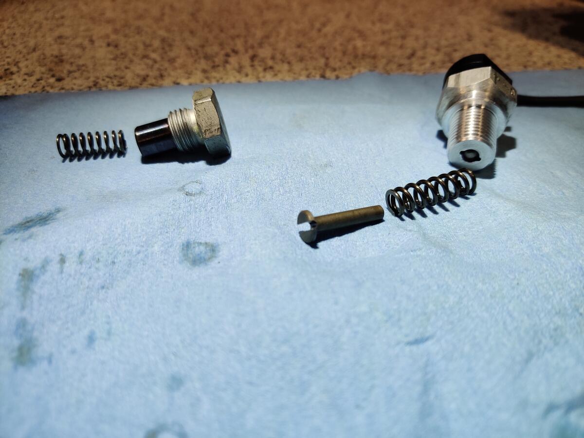

        If you can't find a gate or get it into a gate (i.e R / 1-2 / 5-6) then its a detent spring issue. That is the ONLY issue a broken detent spring will cause. is a roller on the shift rod inside the trans. The roller presses on the spring which provides some feedback as to which gate the shifter will go into. The R detent spring is the heaviest spring which is why it takes more effort to shift into reverse.
        If you are losing 1-3-5 or 2-4-6 or having difficulty getting into gear, its a clutch or transmission issue.
        Sounds like you have a clutch issue. Time for the tranny to come out. I'd guess 50% of the time its the throw out bearing. I now pull off the race (the part that sits against the pressure plate, degrease the bearing and repack with wheel bearing grease.
          Yeah, that's my fear. Below is the #14 - 16 spring (on left) which means both detent springs I've been chasing today are fine. So ruling out the easy things. I may try to rebleed the slave cylinder.

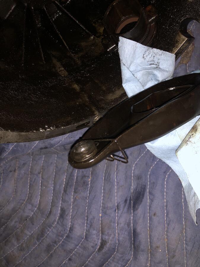

                  Should have closed out this thread with the final verdict on my car. The transmission spring was originally a hunch having read about SMGs snapping the spring, where the SMG exhibits a behavior similar to how I was shifting to drive around the problem (SMGs with a broken spring would significantly delay upshifts until RPMs dropped, or skip gears). In the end my spring was fine so it was not the problem, and I never found a verdict on whether this is something that happens on 6MTs with any regularity despite sharing the same Getrag box.
                  After continuing with the clutch / flywheel job per the other thread, I discovered that it was not only the plastic pivot pin that had completely sheared, but my throwout bearing also had a really nasty crack in it. Not sure which failure led to which, but considering the clutch I pulled out at 180k miles appeared to be the factory one, it was long overdue. The combination of broken pivot pin and TOB meant the clutch fork was out of alignment and unevenly disengaging the clutch, creating this condition at high RPMs. It's really a wonder that something like this wasn't causing any observable noises by my ear, but I suppose with the clutch in everything is under pressure / compressed and therefore wouldn't rattle. I was having the most issue getting in / out of gears 1/3/5 similar to what you describe, but as time wore on just about any attempt to shift above 3k would have the shifter fighting me or grinding if I really pushed the issue.

                              There is one more part under the spring and pin: the pin with a roller. The roller tend to break causing difficult to shift.
                                You need to pull out the ball and the roller pin to make sure they look good. They are the ones that riding on the shift rods, not the springs.
