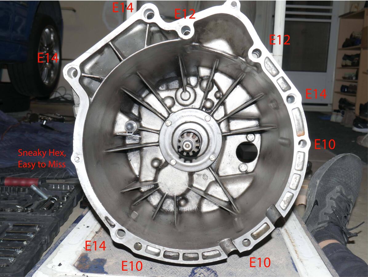

      I'll drop this here as I wasn't able to find any videos or guides during the job that showed the exact locations + sizes of the various mounting bolts for our Getrag box. When doing this on jack stands you're snaking extensions in more or less blind because of how tight the transmission tunnel is, and I lost a ton of time trying to seat the e-torx sockets onto the upper bolts, which were all gunked up with accumulated grime. Carefully lifting the engine as high as possible to let the transmission hang down (without mangling the fan) helps a lot.
      To further complicate things one of my topside E14 bolts was mangled either by a previous mechanic or one of my attempts to break it free, which was a massive head scratcher as I couldn't get the socket to seat properly. I ended up risking it with a E16 socket and got lucky I didn't strip it and completely screw myself over.
      Click image for larger version Name:	Labeled Tranny Bolts.jpg Views:	0 Size:	148.9 KB ID:	132334
      This is SO HELPFUL, thank you!! Greatly appreciate the pointers. Love that these are all different sizes and probably with different torque specs (haven't looked that far into this project yet).
      I may wait on this and drop the motor and trans altogether as a unit. I have another larger project I'm considering (full respray) and would need the motor out for that. However, I'm trying to determine what exactly my issue is NOW so I have parts on hand if need be.

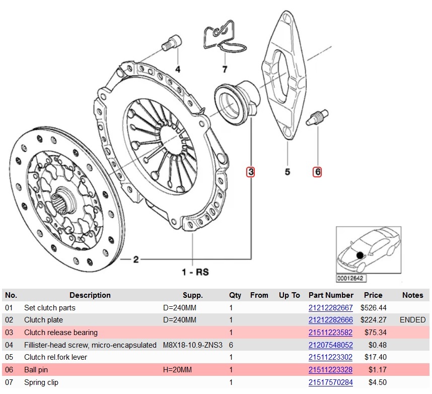

                            So after all of the things I checked off in my last post, I took the car out this past weekend. At high RPMs in any gear, the tranny was having a hard time coming out of that gear - 2nd, 3rd, 4th... dealers choice! In the short drive, it got progressively worse. After one final pull through 2nd gear (not at WOT, just wound it out at partial throttle), I pushed the clutch pedal to the floor and tried to shift into 3rd and two things happened:
                            1) It wouldn't come out of 2nd at ~7k RPM (I wasn't forcing it to come out, but it wasn't having it)
                            2) Depressing the clutch pedal did NOT disengage the clutch. It was as if the clutch pedal was a dead lever that did nothing. Pushing in the clutch repeatedly made no difference, the car stayed in 2nd with the clutch fully engaged until the RPMs came down far enough.
                            When the RPMs came down to about 2.5k, I was able to get it out of 2nd by slowly rolling on the throttle (just enough to relieve drivetrain stress from engine braking). The clutch pedal then worked slightly, (not well) but enough to get it into 3rd and crudely into 4th. I could feel a fairly strong wobble coming through the pedal in my foot as I released the pedal to engage the clutch.
                            I then limped the car home in 4th. When home finally and stopped, the clutch was working just fine (disengaging when I depressed the pedal) albeit there was still a wobble present.
                            My thoughts are it's either a TOB (#3 below), a broken ball pin (#6), or both.
                            Could it also be the clutch itself? There is no weeping of the slave cylinder whatsoever and keep in mind I just bled it again. At lower RPMs, the clutch releases (although the wobble is getting more apparent, per earlier comments).
Name:	M3 Clutch.jpg
                              #44
                              It would be very interesting if this all came down to a $1.17 ball pin. Regardless, time to pull the tranny...
                                #45
                                Won’t know until you drop the transmission…but it sounds like a clutch or pressure plate issue.
