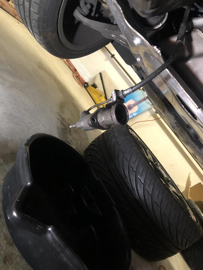

          While putting things back together tonight I must not have seated the slave cylinder properly while reinstalling and it burst when I went to start the car.
          Looks like regardless of the diagnosis the tranny is definitely coming out now, because the rest of the parts are inside of the bellhousing 😂
          When life gives you lemons...
              Yea, the slave push-rod had no load because the rod mis-aligned with the clutch fork, and so the slave piston gut and rod fell out in the bellhousing when the clutch pedal was pushed down -- it has nothing to do with engine run or not.
