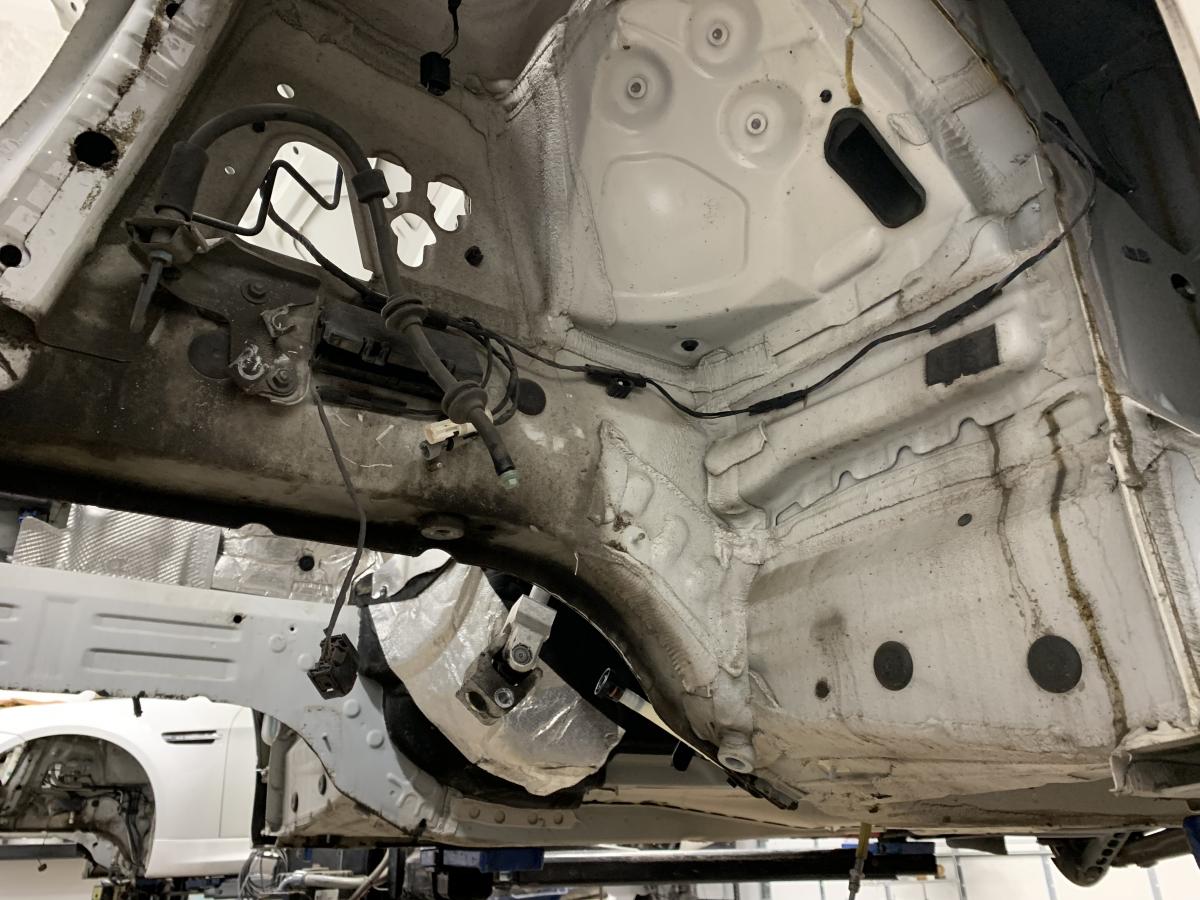

              I made caps myself, very practical when you play a lot with these cars.
              I cut the rubber from old brake lines and weld/plug the make caps, see picture:
                Vacuum caps w/zipties, locally available and definitely work.
