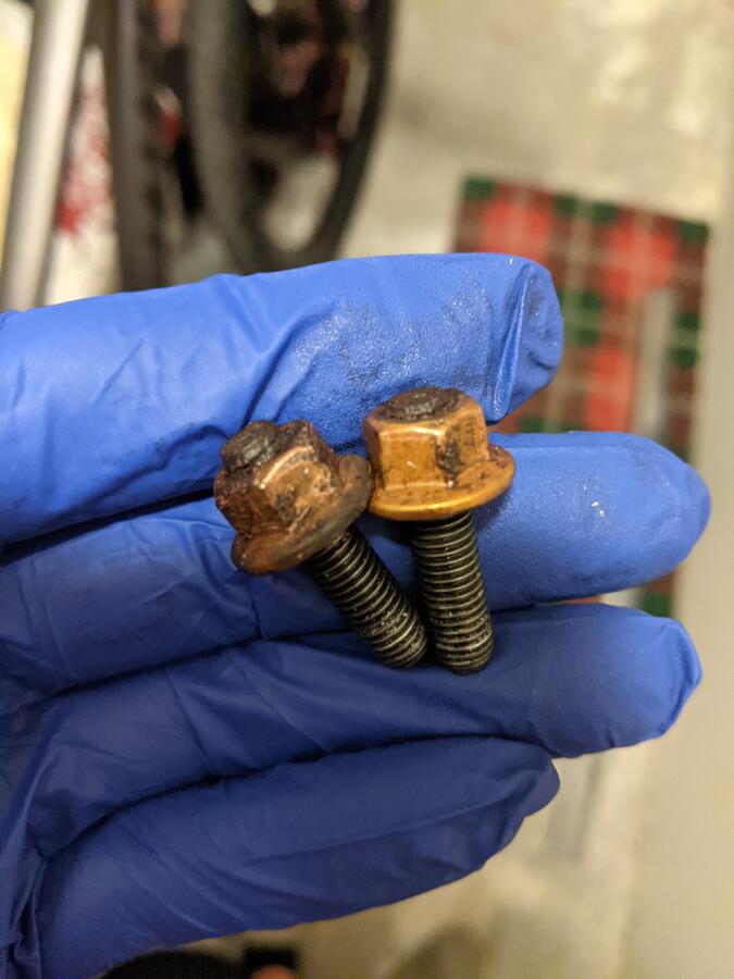

          I attached a photo of 2 studs that came out. Is it possible to retighten on the head without the header and then try and get the nut off again or would I risk stripping something?

            I wouldn't risk stripping the head. Throw them in some vinegar for awhile and remove as is. Another technique is melted wax, etc.

              Use double nut method with some PB Blaster and you should be able to re-use the studs. Just always, ALWAYS make sure your stud hole is clean and when you do final run down of stud use a bit of anti-sieze.

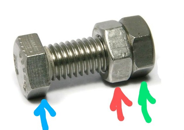

                I would just do it on the bench. Attached a pic to aid in communication. I know it's a bolt, but just imagine it's a stud with a seized nut, like what you have.
                Spray them with a bunch of penetrant. Then put two nuts (red + green arrows) on the free side of the stud and tighten them against each other to lock them. Hold by the nut closest to the center (red arrow) and use a ratchet to remove the seized nut (blue arrow).
                Click image for larger version  Name:	maxresdefault~4.jpg Views:	0 Size:	39.4 KB ID:	101571
                Or just get some new studs (they're not too expensive).​

                  This would definitely be a safer option, or better yet get some new studs. Have a local BMW dealer? Could get them very quickly.

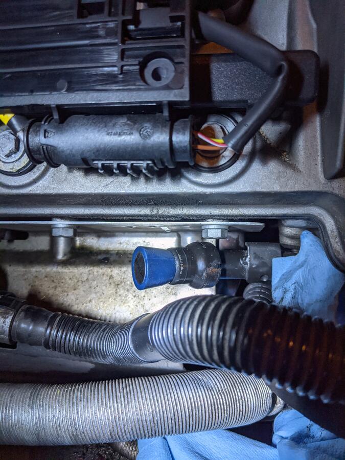

                            Good evening I’m in the process of installing euro headers and a sun beam race mid pipe with the EGT and O2 sensors. and while I was taking apart the O2 sensor wiring loom to de-loom it to route the post Cat sensors around the back of the driver side. I noticed this hose pop off and that exposed connection and was curious if it’s connected to itself or connect to somewhere else if anyone can chime in, I’d really appreciate.
                              #44
                              The small rubber hose your finger is touching should connect the metal pipe to the amber tube. This supplies vacuum to the fuel pressure regulator.
