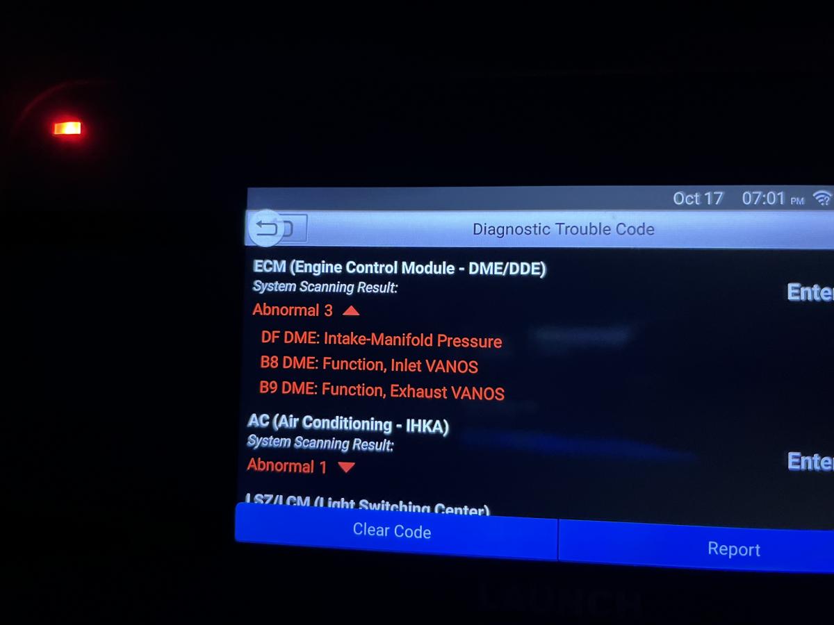

                        UPDATE
                        Scanned the car with an actual BMW scanner and got the following codes —
                          Originally posted by cornerbalanced View Post
                          P0012 - "A" Camshaft Position - Timing Over-Retarded
                          P0014 - "B" Camshaft Position - Timing Over-Advanced
                          The good news is that your car will run better. You can check the vanos timing fairly easy by following post #50 in this thread:

                            UPDATE
                            Just had to replace the battery. After putting the new battery in (resetting codes etc) the car had an extremely rough start and stalled. After starting it again I got another rough start but was able to keep the car running by keeping the revs up, as soon as I let off the throttle it would die. However, after driving around the parking lot and pulling back into my space it idled perfectly fine. Maybe with a very slight variation.
                            Still at a loss for the issue. Solenoid? Cam Position Sensors? A tech friend of mine said the pin that holds the timing chain guide could have snapped, so the timing chain guide is just hanging on inside the engine and my timing is completely out of wack. Don’t want to spend endless money chasing the issue by throwing parts at it.
                            Car has a CSL airbox, don’t know if that would affect how it starts after being completely reset.
                              I believe I saw the ad for this car when it was being listed. IIRC, it had over 100k miles and a CSL airbox conversion.
                              Are there any records of the VANOS being serviced from the PO? Usually, you can tell if you open the valve cover and have a look. It is unlikely the upper timing chain guide bolt snapped. If nothing obvious shows up, a replacement solenoid is the easiest thing to try first. There can also be an issue with the tune as weird VANOS codes can pop up from that. Did the PO give any info on who tuned it? Alpha-N or CSL MAP?
