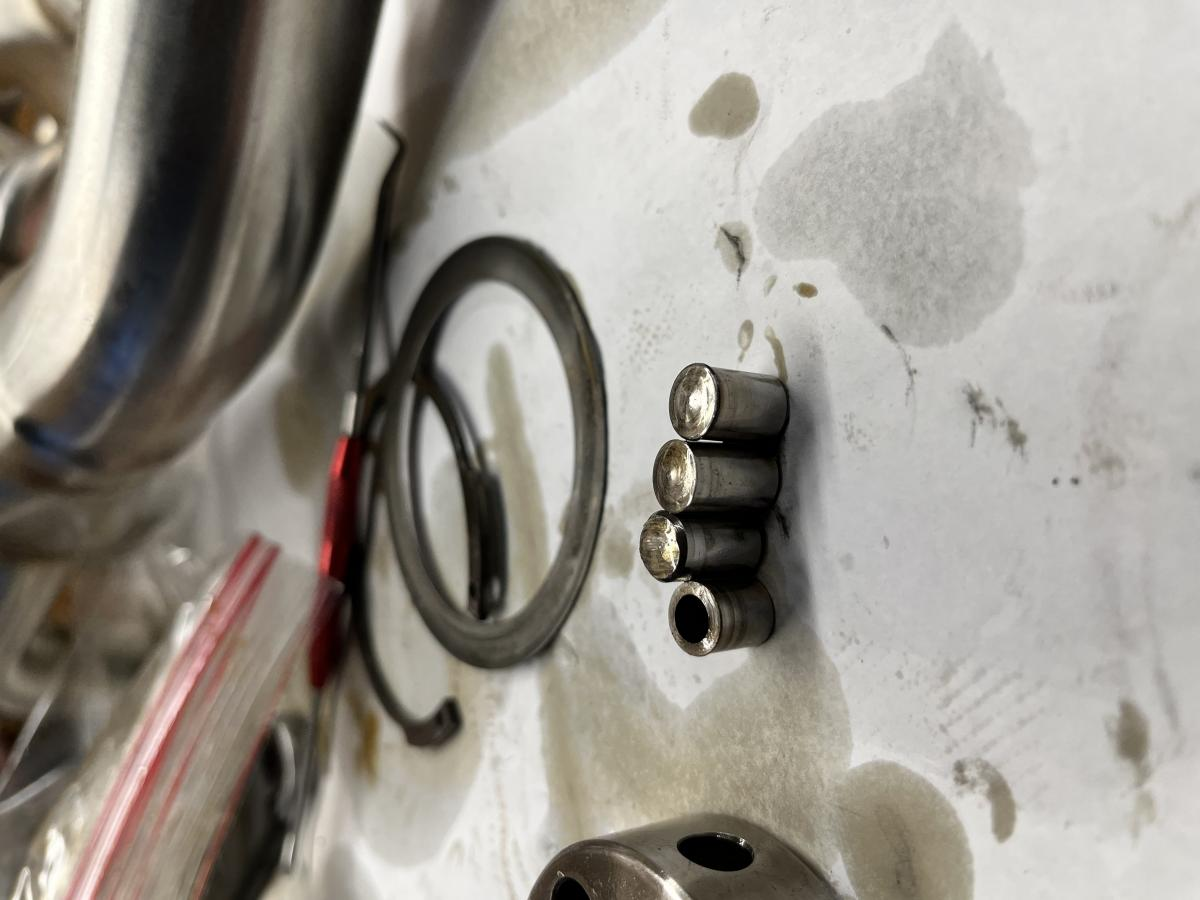

                          The pins inside my oil pump disc backed out and were scoring the walls of the VANOS unit itself—I think this led to a lack in VANOS oil pressure which tripped the codes? Unsure. Pictures attached. Ended up purchasing a new NOS VANOS unit…shortly thereafter I suffered from rod bearing failure, I think the amount of time I drove the car with the VANOS fault contributed to this complete engine failure.
                          For posterity, I will mention, before this failure the VANOS was rebuilt by kaiv (well known mechanic and forum member) using a Beisan oil pump disc. The failure occurred ~10,000 miles afterwards. This was not the fault of a factory, untouched unit but instead a rebuilt one.

                            Beisan new pumps had been known for having sticky pistons (you called pins), leading to low pressure. The pistons riding on the roller bearing and I don’t know why they could damage the bearing and scored the housing.
                            As about damaged engine due to bad vanos: if the red oil pressure didn’t turn on then the engine had enough pressure for bearings.
                              Looking at this pic showing the flatted down pison end caused by sliding on the seized roller bearing. It's so rare to have this bearing that seized up. This should cause a weird noise in the vanos and you didn't detect it? That flat-end piston must be seized inside the disk tight and ended up eaten by the bearing inner race. The other 3 pistons slid over the seized bearing with scrored ends but not flatten.

                                Can you confirm the roller bearing was seized?
