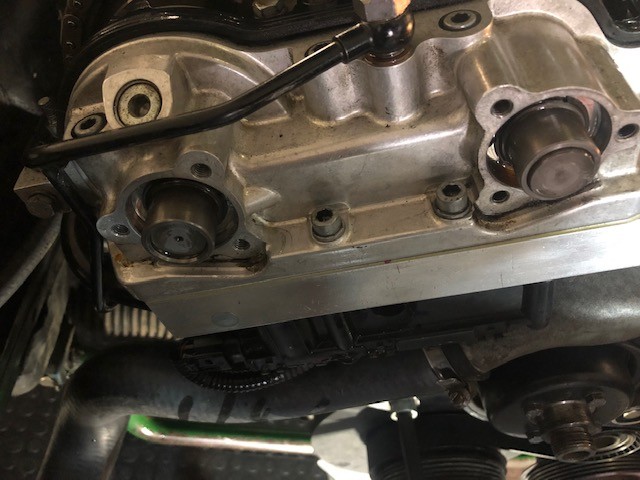

ID:	188398 advanced on the exhaust as we have surmised?
                    #54
                    Originally posted by JBAshland View Post
                    The intake side is protruded about 2 mm, but the exhaust will go no further. This leads me to believe that the timing is set too advanced
                    Look at the EX splined shaft and see if it had protruded far enough. If you turn the EX cam far enough it should push the splined shaft off the hub which you don't want to push this far. The spines can jam tight so you need rock the cam to push it out.
                    Yeah, 13v at the cam sensor is a healthy supply.
                      #55

                          It did show that it was advanced - it was pretty far off...so I have likely been chasing issues, throwing parts at it as opposed to checking what was really going on. I was not able to push the EX piston 2mm forward of the vanos module - it was basically flush and after taking off the Vanos, I could see that the EX piston would only travel flush (maybe slightly extruded) until it was impeded on the other/engine side. The Intake piston, 2mm no problem. At one point I was doubting whether I had the correct splined gears on the intake vs exhaust side, but they were in the right place. Either way, thanks for all your help.
                            #58
                            1. I was not able to push the EX piston 2mm forward of the vanos module - it was basically flush and after taking off the Vanos, I could see that the EX piston would only travel flush (maybe slightly extruded) until it was impeded on the other/engine side.
                            2. It did show that it was advanced - it was pretty far off...so I have likely been chasing issues, throwing parts at it as opposed to checking what was really going on.
                            1. I don't see why the splined shaft cannot move forward and push the EX piston 2mm out. I guess turning the EX cam CCW to move the splined shaft forward may not be a good idea in all cases, because the splines helical cut is not a steep angle, and so it is hard to translate rotation to linear motion in this case, especially if the piston has new seals and little tight. In this case, I should have asked you to remove the vanos module off the head, then manually pull the splined shaft out (but not completely out of the hub) while rotate the EX cam CCW, then install the vanos and the EX piston should be protruding out.
                            2. This case shows that it is not a reliable way to check vanos timing by just rotate the crank to TDC compression then check the cams with the bridge tool pin. As in this case, the OP could not push the piston pass the vanos with the removed cover. So it is better to remove the piston covers then push the pistons out by 1 or 2mm, then install the covers back and this gaurantee the cams are at their max retarded position before checking with the bridge pin.
                              #59
                              FYI - In my case, even after removing the Vanos and checking it out on the bench, I could see that the splined shaft along with the connection to the piston could not physically move forward 2mm out. It stops at flush as the front/flat side of the helical gear stops at the oil pump disc whereas the intake piston will protrude 2mm. I searched around a little bit and from various videos and pictures I saw, this was consistent. Sounds like you have seen otherwise?
                                So when the splined shaft touched on the pump disk, the piston doesn't protrude out of the vanos? It must, although less than 2mm, as I don't think the designer wanted to use the pump disk instead of the cap to set the max retarded for the EX cam.
