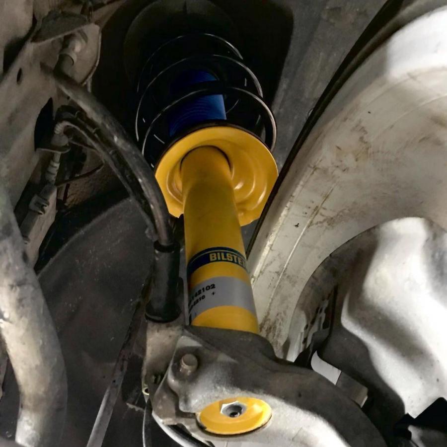

    Hello,
    Can I get a few confirmations whether or not it's normal that the B6 strut won't go down in the knuckle up to the line that's on it?
    The OEM sachs went down a couple inches below the knuckle so this looks a bit suspicious to me... but I tried hard and it's doesn't seem to want to go down.
    Thanks

          OK, to be clear I'm not asking about axial alignment. There is a line on a sticker that lines up with the rear of the knuckle. My question is about how low in the knuckle they should sit. There is no indentation at all on the struts.
            Yeah you're ok, your install is accurate.
            The body does not penetrate the carrier any further.
            The factory, Sachs, and koni will extend below the knuckle.
                  You're okay. I installed those exact shocks on my car in mid 2020. Axial alignment to the sticker, and they bottom at into the bottom of the knuckle, not beyond it like the stock struts. Also, don't run any external bump stop. The B6 has internal bump stops, which some users have also cut because they're too long for the travel setup on the E46 M3. FatCatMotorsports has a video about how to open them and cut the bump stop (they recommend a certain size + packers...you can research further and do what you want). I tried to open one of mine and almost stripped out the hex, so gave up and just run them as-is.
                    You can also ditch the cad plated (goldish) washer that's quite thick that peovides a ceiling for the oe bumpstop, since you don't need it, which gains decent travel back when paired with lowering springs.
                      I haven't installed them yet, but my B6s do have a small lip about 63mm from the bottom of the strut body. I assumed this is intended to rest at the top of the knuckle?
