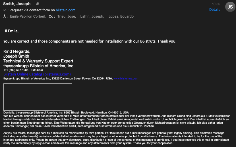

      Tbonem3 is right and this “washer” is not needed according to Bilstein technical support.
      I just asked them and got their reply.

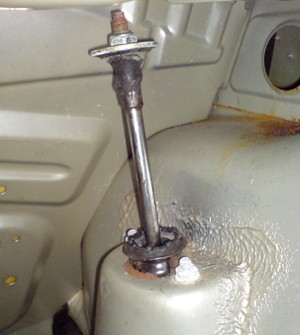

        This is the pounding that the strut mount experiences in normal driving with stock suspension.
        The mounting sleeve is being forced upwards by the hammering.

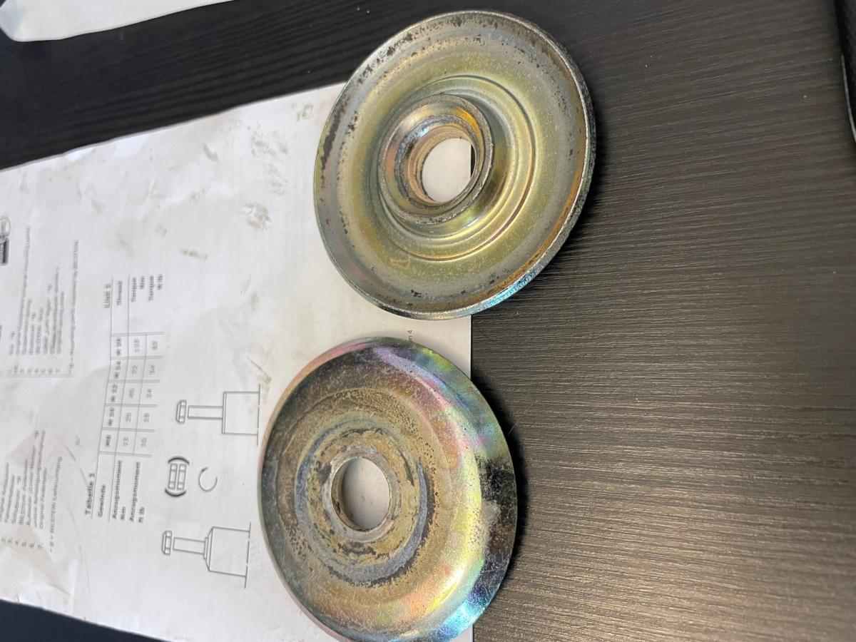

        old on the left, new on the right.
        The rear takes as much and shear forces from the suspension travel.

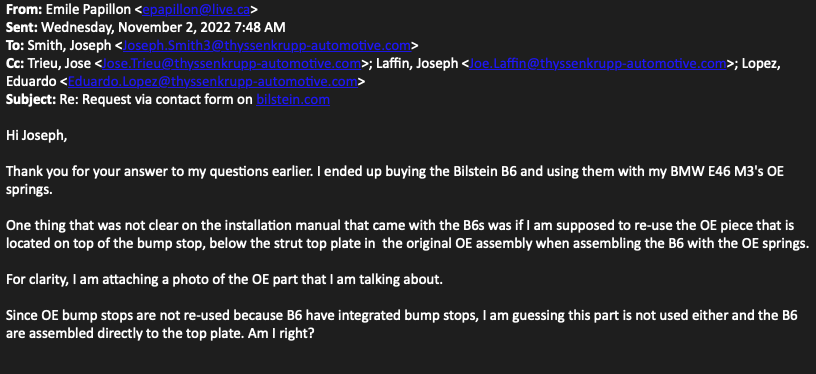

                K-Dawg then you'll have to decide:
                A- I am forging this email for some reason or
                B- Joseph from Bilstein doesn't know what he's talking about

                              Failed strut of a different model car without lower washer installed:
                              Example of the same failure mode, but in a BMW rear shock mount, installed without its lower washer :
                              Click image for larger version  Name:	image_39557.jpg Views:	3 Size:	22.8 KB ID:	191016

                                They are correct, you do not use the OE washer. I’m understanding from this thread that Bilstein includes their own washer that is installed in place of the OE one.
