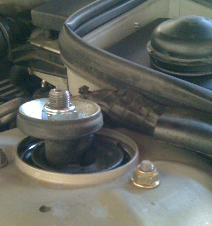

    They are correct, you do not use the OE washer. I’m understanding from this thread that Bilstein includes their own washer that is installed in place of the OE one.
    They don't provide any washer with the B6. I'm starting to think Joseph from Bilstein answered quickly without checking. What is making more sense to me is to use the stock washer. TMS advise to use the stock washer in their installation manual for their street/track camber plates.
    If used with the washer, the strut shaft is blocked in upward motion as the washer will squeeze against the rubber on the bottom of the bushing. Otherwise I guess it could potentially shred the bearing's metal core out of the rubber and poke upward 🤨 like in your photos.

        I remember now! This was a common problem with the e31 8 series when installing bilsteins. If the washers were left out, the upper strut bearing would fail and the strut would dent the hood. The e31 uses the same style of strut mount as the e46 M where spring and damper loads are decoupled. See: https://www.bimmerforums.com/forum/s...top-inequality
        edit: image from linked thread:
