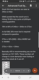

                    I read the at WOT at around E70 to E80 maxes out fuel injectors back on M3forum. It has all the info on the injectors sadly. Can anyone post the stock duty cycle at WOT with 93? Preferrably one of you guys that can read the ethanol content so we can get an accurate number. Everything is at least up to 10% and ethanol free only goes up to 89 from what I've seen. From this we can figure out the sweet spot for needing larger injectors or not. It won't be perfect but we can get a ballpark number. Who knows, E70 could have the injectors working at 100% and anything above that is pointless. I'm super interested in this and it's reassuring to see a few of you loving your conversion.

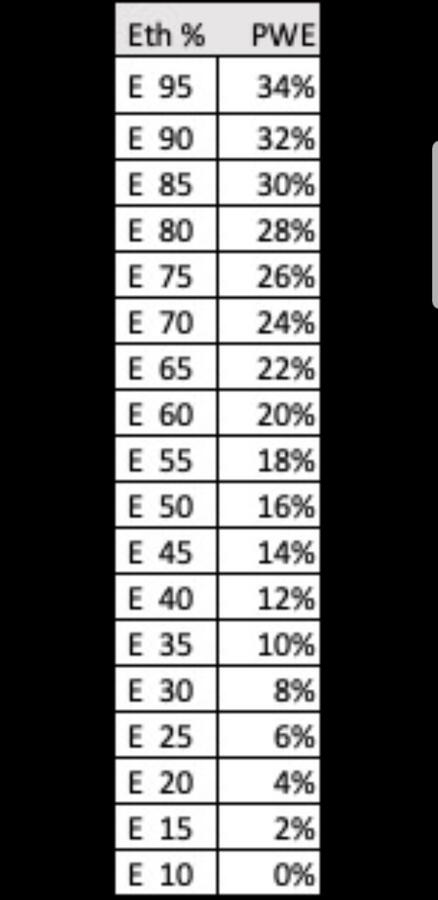

                      Here are a few screenshots I saved from old forum to add to the discussion:

                            I referenced the government energy website to use as a baseline for the math which I linked. Basically 120,359 btu/gal is what E10 has. I used pure gasoline(124,340btu/gal) and E100(84,530 btu/gal) to find this number. That's not really relevant until compared to actual E85 where percentage matters. Here's the percentage of the ethanol needed to accomplish the same amount of btu's. Just a note, fuel injectors shouldn't be going over 80% duty cycle. From what I read on wikimotors, 247cc was supposed be the rating but Buildjournal was getting 260cc when testing them at 3 bar.
                            I have written fuel, btu/gal, how much more is needed, increased cc's based on the 272 number, and percentage of 340cc max. 340cc is an accurate number after doing the math. Based off of 260cc it would technically be a 337cc max but there's a 2% tolerance so it can slide.
                            Fuel - BTU/GAL - % More Needed - Req Flow - Inj Duty Cycle:
                            E50 - 104,435 - 15.2% - 313.3cc - 92.1%
                            E55 - 102,445 - 17.5% - 319.6cc - 94%
                            E60 - 100,454 - 19.8% - 325.9cc - 95.9%
                            E65 - 98,464 - 22.2% - 332.4cc - 97.8%
                            E70 - 96,473 - 24.8% - 339.5cc - 99.9%
                            E75 - 94,483 - 27.4% - 346.5cc - 102%
                            E80 - 92,492 - 30.1% - 353.9cc - 104%
                            E85 - 90,502 - 33% - 361.8cc - 106%
                            E90 - 88,511 - 36% - 369.9cc -109%
                            E95 - 86,520 - 39% - 378.1cc - 111%
                            E100 - 84,530 - 42.4% - 387.3cc - 114%
                            In conclusion, stock fuel system is maxed out on where it should be at 80% already. Ideally you want to upgrade no matter what. I doubt an injector 15 years old is functioning at 90%. Remember commanded duty cycle and actual flow are two different thing. I've found in multiple places the 85-90% is the max an injector will actually flow without problems. The computer can only measure what it sees. It doesn't read flow, just what it thinks is flowing because it's pulse width modulating. Theoretically, without accounting for worn injectors, the absolute max you can run is E50 without losing efficiency. This injectors work and your ECU will adjust for AFR to run well but that doesn't mean it's working as it should. Cars are smart enough to not cause knocks.
                            I would assume advertised injector flow is tested at 3 bar which is 43.5psi while ours function at 5 bar or 72.5 psi. Upgrading to a 330cc injector gives you usefulness to 340cc. Switching to a 440cc rated injector will give you usefulness up to 454cc effectively. This is based on keeping the duty cycle at 80% or below. For an E85 goal, the perfect injectors to complete the needs required are 440cc minimums to do the conversion properly. 330cc is only good to E70.
                            Hopefully this was helpful in some way. Feel free to verify my math. I used the chart above and these websites. I have a feeling someone isn't going to like the whole injectors don't work well past 90% ordeal. Well, they don't and I'm sorry this isn't a perfect world. My chart is subject to be a few percent off due to fuel temperatures, actual fuel pressure, sea level, and gas additives.
