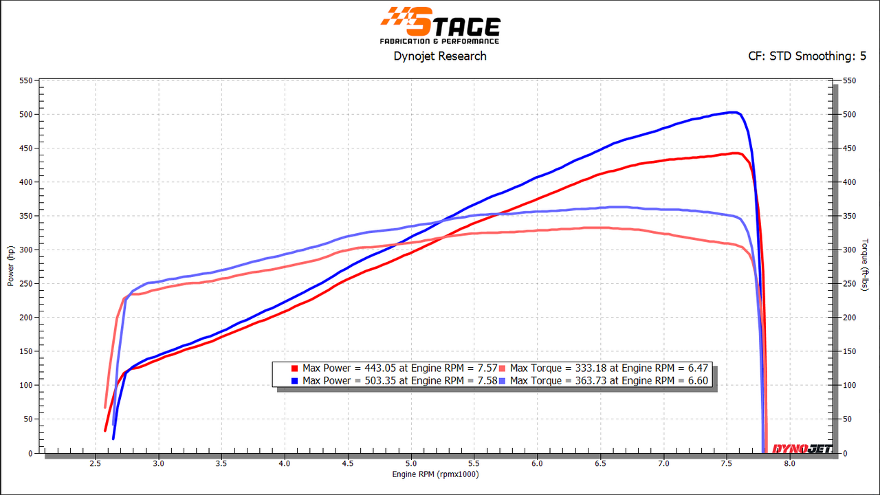

                      Just sharing my recent experience with E85 and few additional tunes added to mss mapper on steering wheel,
                      Map 0 - 93 Pump Gas Only No Nitrous or Meth <<--------- baseline dyno below,
                      Map 1 - 93 pump Gas and Meth Only
                      Map 2 - 93 Pump Gas and Nitrous Only
                      Map 3 - E50 Mix (50% 93 and 50% E85) No Nitrous or Meth <<----------- dyno below,
                      Map 4 - E85 Full (No 93 at all) No Nitrous or Meth
                      Hoping that with map 4, will go slight high north of 503 rwhp

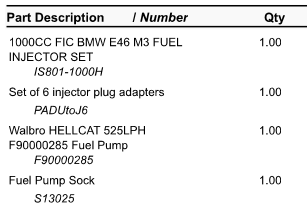

                          The E85 setup has following hardware's,
                          Click image for larger version  Name:	image.png Views:	0 Size:	8.8 KB ID:	111919
                          Had to upgrade the fuel pump fuse from 20A to 30A.

                            Good numbers, how much boost?
                              #44
                              9 psi
