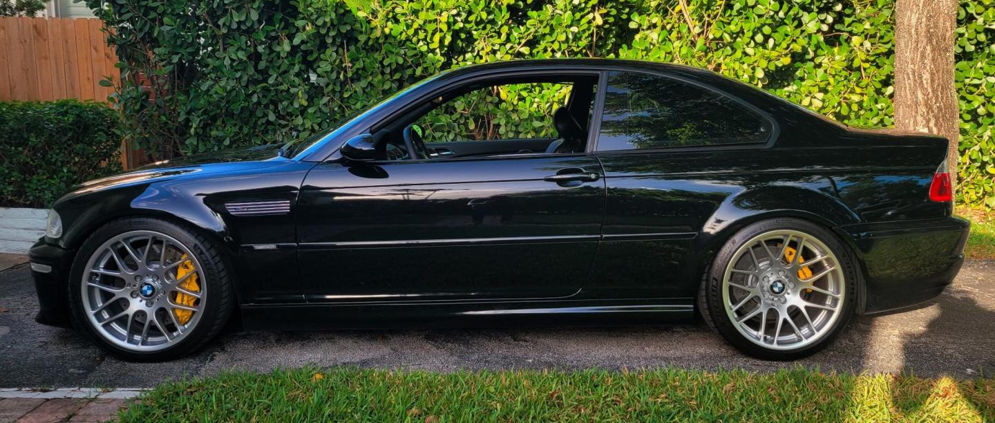

        Can we see the rears as well? I want to see what a 360mm front rotor and 328mm rear rotor look like together.
        Here is a crappy cellphone pic of the back and front together.
          #34
