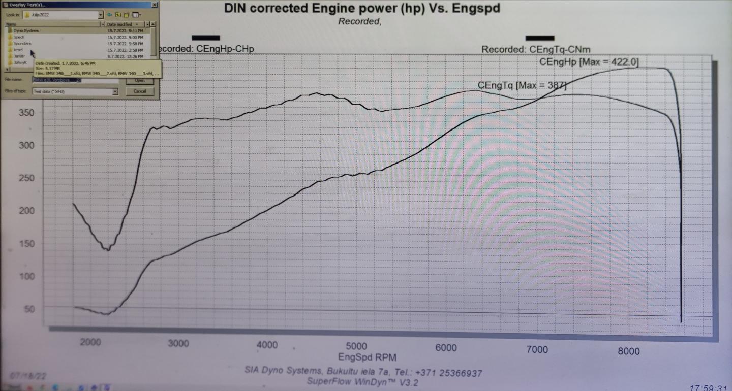

ID:	211144Hello from europe,
    s54 built - je 12.5:1 pistons, actual cr 12.2:1
    Chinesium H beam rods Athena fire ring gasket,
    Stock ports and chambers,
    Cat cams upgraded valve springs
    Cat cams 304 296 cams with 13.75/13mm lift,
    limited vanos travel because of ptw clearance
    Stock headers
    Self made csl airbox copy from glass fiber.
    dual 2.5" exaust with x pipe and dual silencers in back.
    porsche 911 640cc injectors
    Modified flow through fuel rail
    Aftermarket motec ecu running alpha-n tune
    Fuel is european e98 standart which i suppose corresponds to usa 93 octane
    Arp head and main studs
    Acl race bearings
    Figures shown are flywheel, as per whp i dont remember the exact number, but it was around 370hp.
    As on the problem side, it has oil overheating issue and setrab oilncooler and hard set oil termostat isnt helping that issue at all, yes ofcourse we may have airflow issues on the radiator, but analag car with s50 engine and 380 hp has not even a scent of the mentioned problem.
    Right now i am suspecting that maybe inadequate combustion chamber evacuation may be at faul - it leaves much residual heat which is heating the piston which then gives off heat to the oil throgh squirters cooling it with the said oil.
    Im now thinking of that assumption because the engine breathing sound is a bit weird also the exhaust is quieter than the intake, which per my opinion shouldnt be the case given the only two small silencers it has.
    im now thinking of reducing exhaust pipe diameter as well as increase the middle section of the x pipe, which is only slightly larger than the pipe as it is built like 2 pipes crossing each other at 30° angle, with no extra widening at the middle.
    Also i would be wery thankful for some advice and open to opinions.
