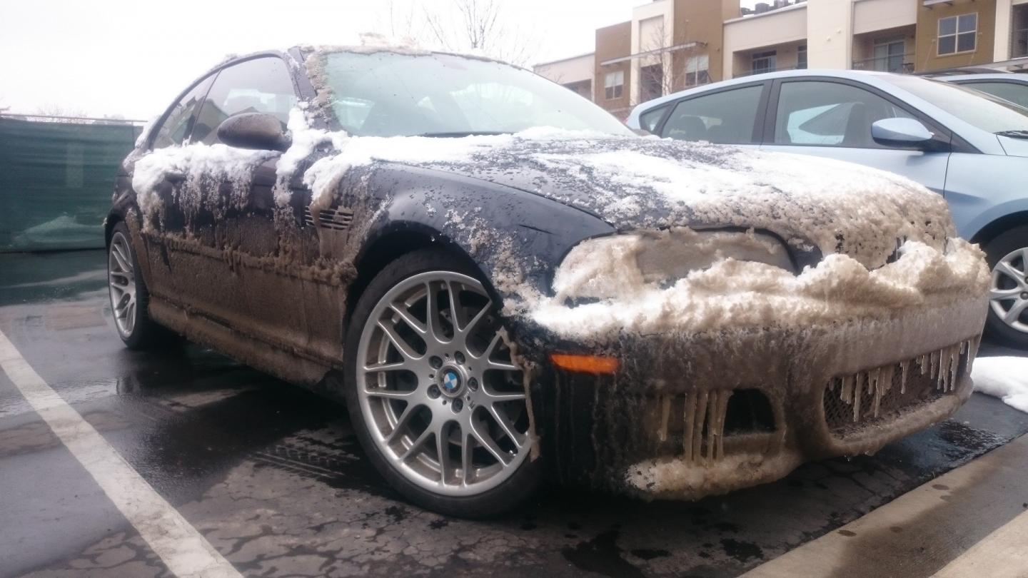

                  I live in Denver and they got me through a few winters. I preferred them to actual snow tires, but I think getting off the line actual snow tires could be better. I mostly drove with them on the highway. Never got stuck except one time I high-centered the car (still not the tires fault!)
                    Good quality snow tires are always going to be better than all-seasons for real winter driving.
                    This is heresy, though. I will not even drive my car in the rain anymore. That picture above makes me feel ill. Brings on nightmares of what happened to my old e36. Keep an eye on that trim piece between the rocker panel and body.

                        Meh it's fine. E46s are decently well protected against corrosion from the factory. Plus, it's a mass produced 3 series not some low volume special thing. Winter driving won't kill it (note: if you take care of it).
                        Oh and Colorado doesn't salt their roads as heavily as other parts of the US. Purely anecdotal, but it seemed like only the highways would get salted when there was a lot of ice. Smaller roads and highways when there wasn't that much ice would get dirt/gravel.
                        Anyway, to answer the OPs question. Stick with stock tire sizes and some good quality snow tires. Michelin has some attractive looking ones. I ran some meh quality yokohamas on mine for a couple seasons and would still constantly drive past AWD cars with (presumably) all seasons that were stuck. Wish I had worn through those tires faster so that I could try out other stuff before moving to a place without snow. Blizzaks seemed to be popular amongst the car crowd in Colorado.
