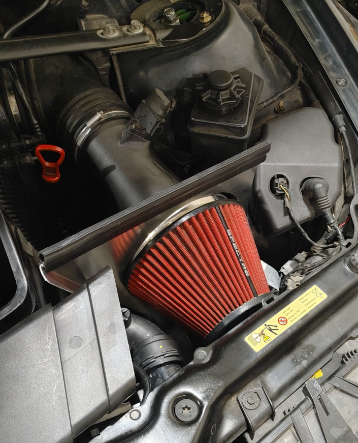

          Update:
          I've had the first functional prototype on the car for the last week or so. (delay after I messed up which way the bends had to go) Had to cut a bit extra for a plastic pipe my scanner didn't pick up but otherwise, gaps are on point after adding in the loop end seal and it follows the chassis sheetmetal very closely on the right. The scanner came in clutch for that.
          Sound hasn't been muffled, possibly improved a bit, from having a bit less strain on the intake. That might be placebo though.
          Currently back to driving the car each day to and from work, and it's still a blast to drive.
          Personal thoughts on the design:
          I really like how the shield design ended up. Unlike the Eventuri shield, it actually captures the airflow from the front duct and the bottom duct really well, and it goes higher up and actually does a decent job sealing against the hood. It's not airtight, but it's a whole lot better than the Eventuri shield.
          Having had the K&N, having this style of rubber trim is much more effective than the stupid rubber that came on K&N's shielding. That thing barely held on to the shield, much less pressed against anything.
          For the stock elbow, having the shield sit on the filter rubber means it's not going to add strain to the plastic intake or mess with reverberations there.
          My only concern is owners with silicone boots. Silicone boots have different angles and lengths and I can't account for all their placements. The way I have this shield designed and mounted means it can move around a bit and flex as needed (I deemed this necessary because engines move under load and I don't want to add strain to the system from a super firm setup. This flex might be enough for some variations in mounting with silicone elbows.

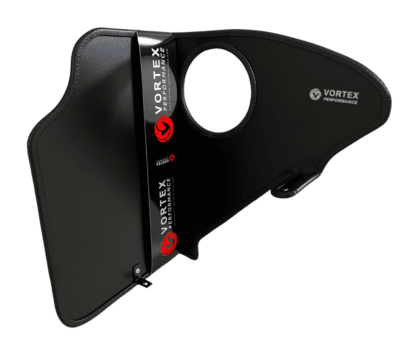

                following for updates on the shield. just picked up one of your pieces locally and interested in purchasing the shield when you're ready to retail it.
                Also saw this while perusing Vortex's website. Any thoughts if it would potentially fit your unit?

                    This doesn't fit, not enough space by the filter area, and hole isn't quite in the right spot either. The shield needs to slant inwards to provide the room necessary. I bought one way long ago to see if it was an easy adaptation. Vortex does make an aftermarket scoop! It's also very affordable.

                      Been well overdue on an update, really sorry for missing my estimates over the last few months. I started spending more time with family for the Thanksgiving and Christmas holidays and didn't work much on 3d printing related projects. Got another family vacation coming up, but have had a few inquiries over email on the heat shield.
                      First production version of heat shields are in, and I got packaging figured out (big 14" box!) as well as trim, a mix of fat rubber D loop seal and a 3d printed insert so there's not metal to intake contact during install.
                      Initial shields will be raw aluminum, because Sendcutsend charges an arm and a leg to anodize or powder coat, and it's below freezing here so I can't paint them myself. So early adopters will need to DIY paint if you want them black.
                      It mounts through a single screw on the bottom, and the whole piece has some flex, to reduce strain on the intake and elbow from engine movement on power. I
                      nstall IS a bit of a puzzle: You will need to have the intake, filter, and shield all loosely together, the elbow off the manifold, and be careful moving the shield and intake combo in. You might be able to get away with the shield in first and then assemble the intake and filter from either side of the shield, but it basically doubles install time.
