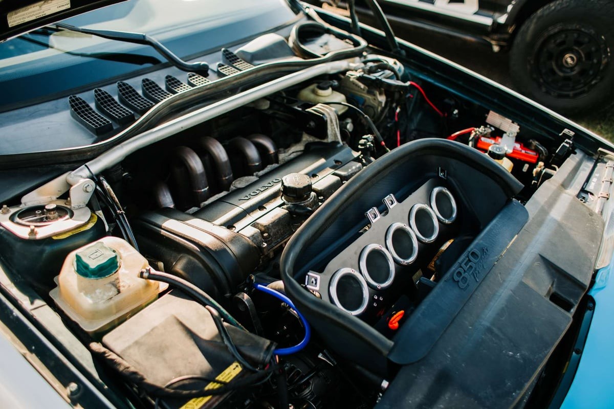

      You could 3D scan the area but the challenge is going to always be getting a tight seal against the bottom of the hood. Which is why the OEM intake usually has better real world performance than most CAIs.
Name:	FCP%20Euro%20Volvo%20850%20Project%20Engine%20Bay%20Beauty.jpg?width=1200&length=1200&name=FCP%20Euro%20Volvo%20850%20Project%20Engine%20Bay%20Beauty.jpg
      All you would need is a proper surround, a feed of cold air (headlight, stock airbox bumper duct, etc), and a bit of bulb weather seal. The noise benefit will really be coming from the tuned thickness of that inlet that OP has designed.
      To be clear, I am not saying this is a better solution than a carbon airbox with all the factory CFD behind it, but this could be a cost-effective solution for intake noise benefit without significant performance drawback vs. a stock airbox. I am aware this is essentially reinventing every competent intake kit (Dinan, Gruppe M, et.al) so it is not rocket science, just trying to suggest solutions for the OP.

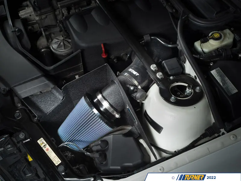

                      Wanted to also poll people on whether they feel good with a walled off heat shield design, or want more of a boxed in design like OEM, Injen, and Dinan. The boxed in design is quieter and IMO defeats the purpose of this intake.
                      The walled off design like K&N, Eventuri, and AFE aren't as great at keeping out hot air at a stop but will make a negligible impact to sound. It should also be significantly cheaper to make and easier to design.
                        #56
                        Originally posted by TeddybearCup View Post
                        Currently running a 10% off sale for this week with code SUMMER23 (1-2 week turnaround)
                        I'd say aligning with your objective (smooth flow with good noise) is the right move. If you'd end up creating a fully boxed design, then I don't know why one would bother buying this over an OEM box. Turner's wall style looks pretty nice, especially grabbing the air from the fresh air scoop behind the kidneys.
