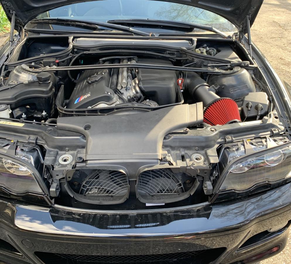

                        Have had this piece on since early March so I’ve gotten to know it pretty well. It’s transformed the car enough to appreciate a notable difference in intake tone and volume. Hats off to OP for the R&D and hooking forum members up early. The print is strong and high quality, and looks right at home in the engine bay. Expectedly, there are downsides, but I have found they aren’t significant enough for me to take it off.
                        Bad news first, this thing is literally a hot air intake.
                        -Noticeably hotter to the touch after a nice drive than the stock piece. (Much thinner material, no ducting)
                        -Until a bracket is made for this it is held solely by the intake elbow and will move and bounce with the car’s motion. Heat shield could help keep it in place and improve temps.
                        -sometimes sometimes a bucking effect, a hesitation if you will. Assuming this is from losing my tubes feeding directly to fresh air.
                        -anyone should be able to discern these downsides solely from the pics. We all know what an intake that looks like this does. We all know the stock air box is as good as it gets in terms of reliabilityerformance. I really bought it for the promises of more sound (and because I love DIY developments) and it has truly delivered in that regard.
                        It’s really no question of what the e46 m3 needs, and that’s a carbon air box. If one can’t eat that cost this is possibly the most cost effective way to get a taste. It sounds good enough that I’m feeling that cliche “can’t stop going WOT” feeling from when I first got the car. It feels so much more alive. It’s a fine piece that has really expanded my enjoyment of this car. One of the most significant changes to my experience for fcab money.
