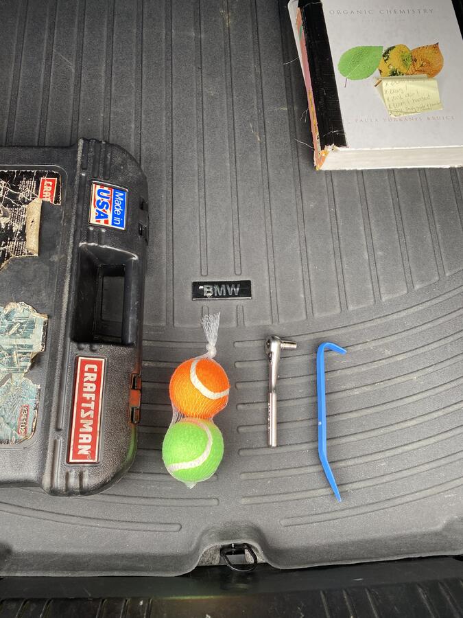

    The tools you need are a 8mm socket, an appropriate ratchet, a trim removal tool or a flat head screw driver, and of course tennis balls.
    Click image for larger version  Name:	IMG_1812.jpeg Views:	0 Size:	104.8 KB ID:	19446

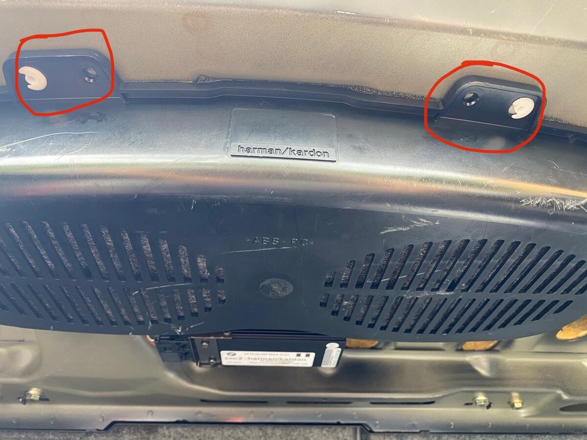

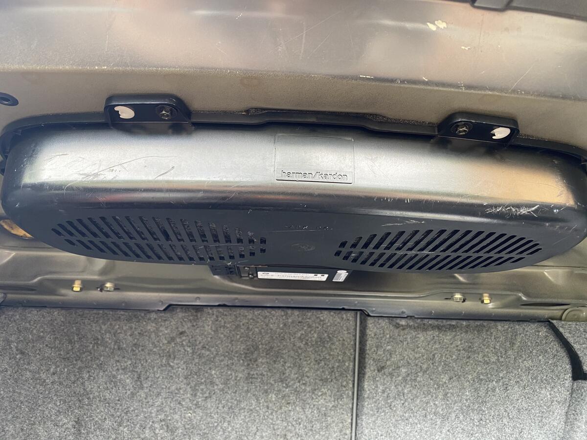

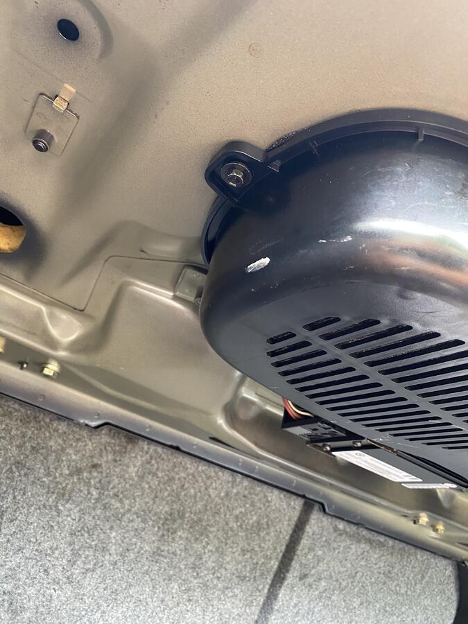

    There are 4 black screws and 2 white clips which hold the subwoofer in place. Note that there are no screws holding the rear of the subwoofer. I have already removed the screws out of the front side in the picture below.
    Click image for larger version  Name:	IMG_1817.jpeg Views:	0 Size:	132.0 KB ID:	19447
    Left side:
    Click image for larger version  Name:	IMG_1814.jpeg Views:	0 Size:	86.2 KB ID:	19448
    Right side:
    Click image for larger version  Name:	IMG_1815.jpeg Views:	0 Size:	113.1 KB ID:	19450

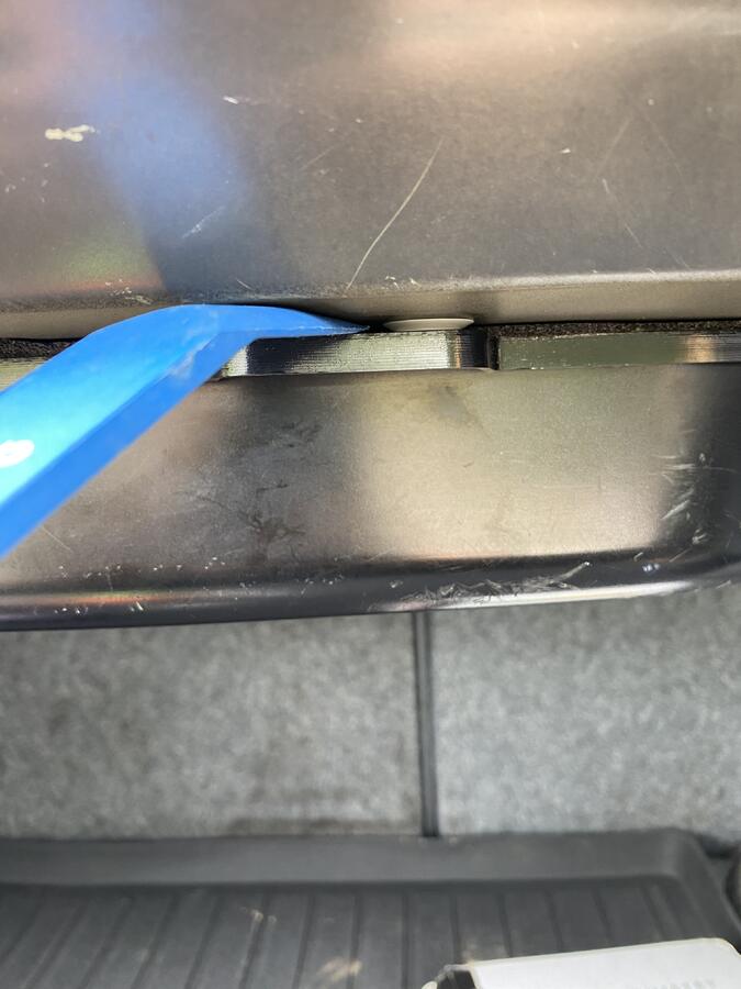

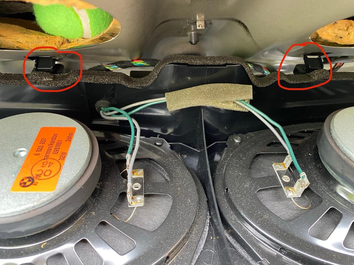

    After removing the 4 screws, you need to pop out the white tabs on the front, I used the trim removal tool to pry them off.
    Click image for larger version  Name:	IMG_1818.jpeg Views:	0 Size:	54.6 KB ID:	19451

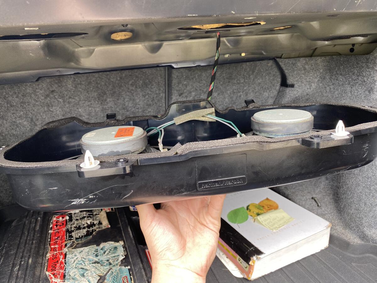

    After this your subwoofer should fall down, be careful not to strain the wires that are connected. You can see the white clips more visibly now.
    Click image for larger version  Name:	IMG_1819.jpeg Views:	0 Size:	158.1 KB ID:	19452

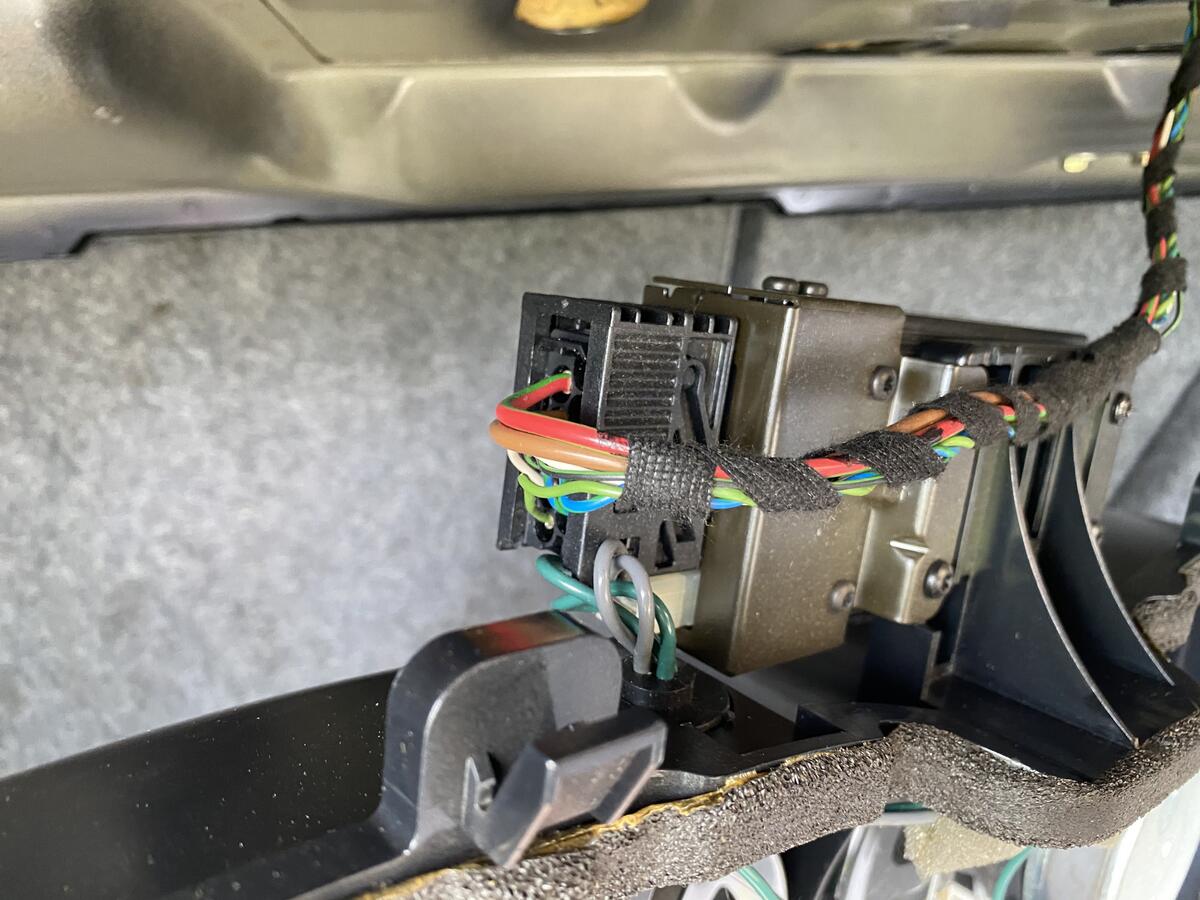

    You can choose to either disconnect the plug at the sub to clean out the subwoofer itself or place it on something that doesn't strain the wires.
    Click image for larger version  Name:	IMG_1820.jpeg Views:	0 Size:	128.1 KB ID:	19453

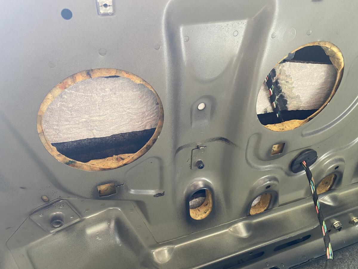

    If you look up now you'll see the two holes and also be able to feel the underside of the deck lid.
    Click image for larger version  Name:	IMG_1821.jpeg Views:	0 Size:	122.9 KB ID:	19454

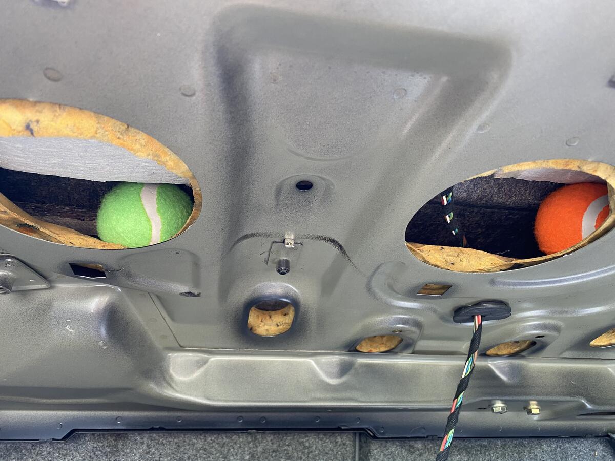

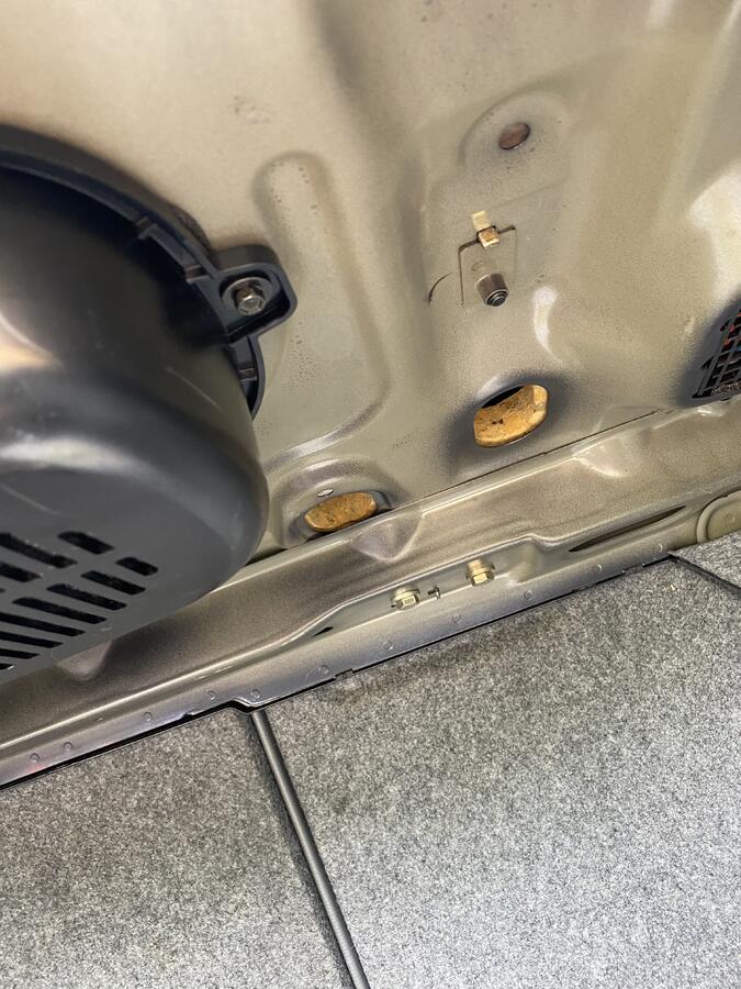

    Feel around for the deck lid and wedge the tennis balls in to prevent rattle, make sure to take a look from the interior of the car to make sure the parcel shelf/deck lid has not popped up.
    Click image for larger version  Name:	IMG_1822.jpeg Views:	0 Size:	136.4 KB ID:	19455
