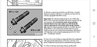

              Thinking about doing this since I have so much time to kill. You guys doing stock rod bolts with angle torque or getting the arp with the stretch guage?
                  Mine is an 02 so I was able to reuse my bolts.

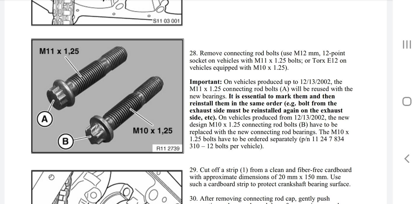

                    OEM if you have a later build date, reuse if you have an earlier build date. Get a digital torque wrench that also reads angle. It makes it so much easier.
                      Regarding bolt reuse:
