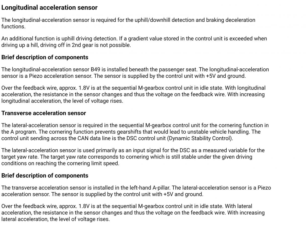

          Ah found it. It's an SMG sensor, which is probably why neither me nor Jae recognized it.
          Click image for larger version  Name:	Screenshot_20221201-092158_Chrome Beta.jpg Views:	0 Size:	184.8 KB ID:	194534
          Checked the wiring diagrams too and it only goes to the SMG ECU. Don't think there's any communication with the DSC about the values this sensor reports, as manual cars don't have it, but I'm not entirely sure.
