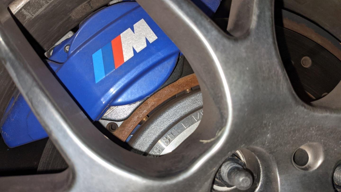

Thanks for the information, and after googling it from other forum, I believe this is the case you're talking about.
But is this going to be a reliability issue or just underutilizing the rotor capacity?
