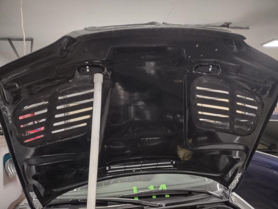

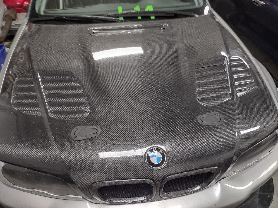

                I picked up a carbon fiber hood from Mike Shaw (http://mashaw.biz/bmw_hoods.asp) in California for the race car. It has functional side vents. I had the front grills from the old hood (aforementioned Seibon boat anchor) and I picked up the carbon fiber rear vent cover from a firm in The UK. The Aerocatch hood latches were installed to avoid weight of hood mechanicals.

                    How was fitment and install? I know yours is a track car, but would it pass some of the more strict personalities wanting close to OE fit and alignment?
                      Install was a breeze. Had to trim a little of the inside to fit the Aerocatch latches and make room for hood prop. Fitment is good. Is it show car quality???!!
