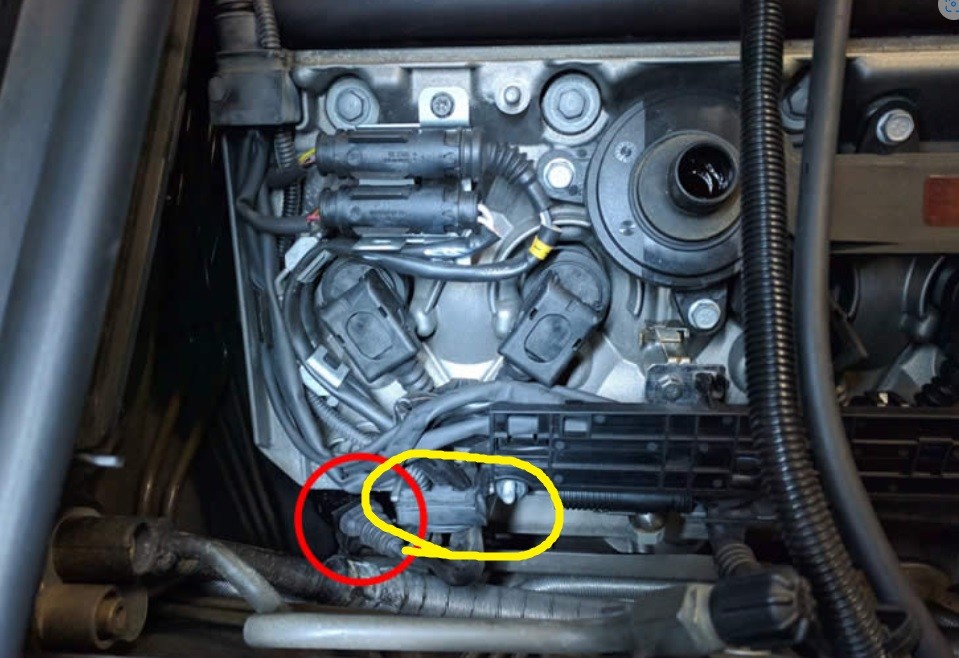

    I've been wrapping up valve adjustment job and while putting everything back together, I've noticed I am missing the following (Circled in YELLOW):

    It is the rubber grommet piece that holds the O2 wiring together & gives a good seal when the beauty cover goes on.
    I cannot find any information on this particular piece on RealOEM under E46 M3 (It is grey'd out). But when I do watch DIY videos or read into guides, I am able to spot the grommet.
    Any thoughts or information would be much appreciated!

        Part in your picture looks like 12517831185. It's in the Z4M parts diagrams but not the E46 M3 one. Although it looks more like a block off plate than anything else. Maybe you can make some holes in it to get the wires through. Or maybe they come out the bottom/side?
        Might have to pick one of these up. It's annoying having to clean under the beauty cover every time I take it off.
          It's very much a thick rubber grommet, that the beauty cover sits on to seal. Great find, looking at Z4. Sadly, realOEM is funky like this. I've noticed a lot of widly incorrect weights listed for parts, and many parts not listed or grey'd out.
            It should be the same as the O2s run down the same path.
