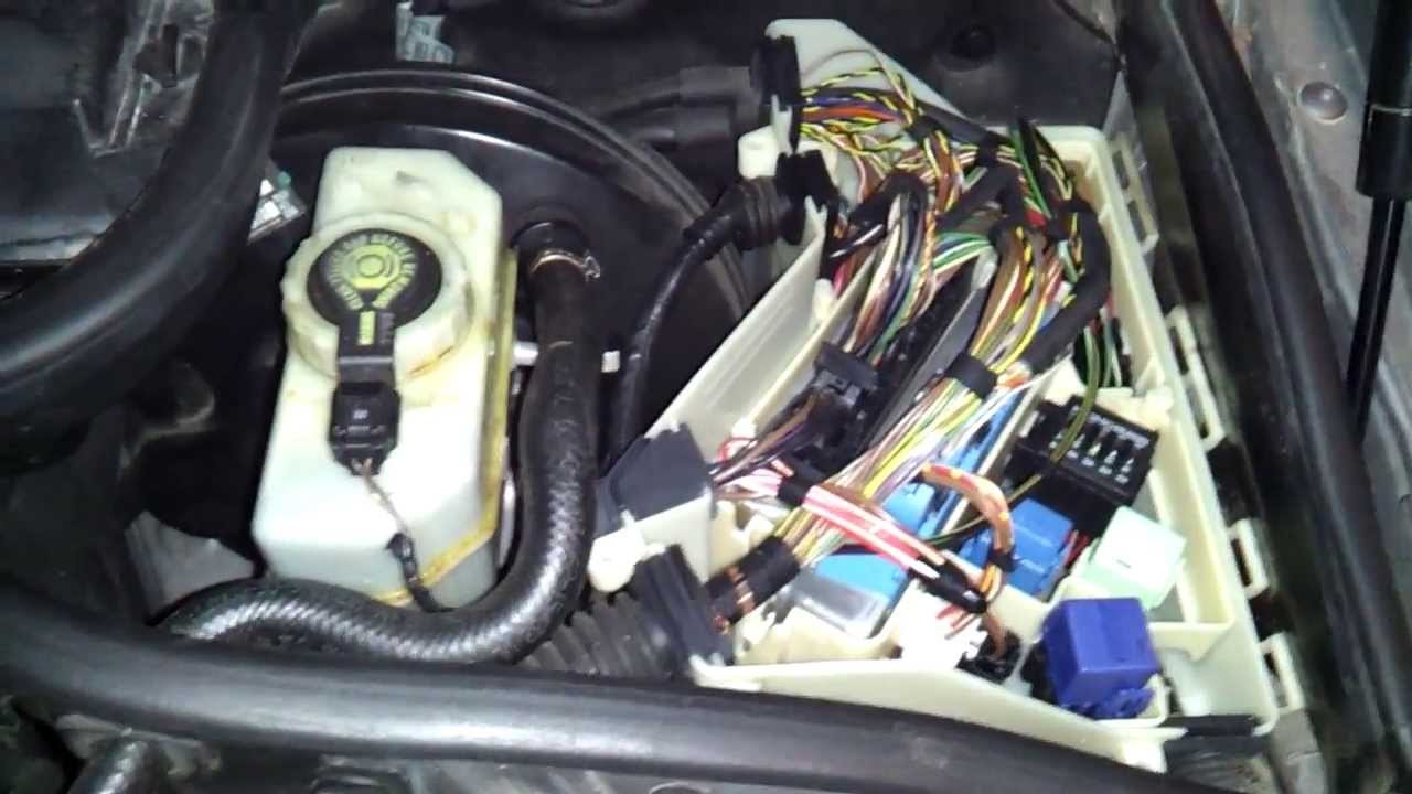

    Have you checked the under hood fuse pack (5 fuses inside a black carrier) adjacent to the relays near the DME?

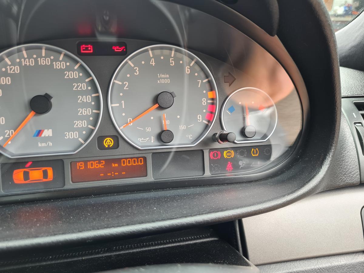

                    Still the lights are on the dash so when checking errors in the DME in INPA I get errors 132, 135, and 139. However when trying to scan the DSC unit I get a "NO RESPONSE FROM CONTROLUNIT" error. Can't read it at all. I suspect the ABS unit is dead but I'm gonna leave the battery disconnected for a while and see. Guess I need to start researching an MK60 conversion. I still need to get under the car and check the main engine ground, supposedly fluctuating voltage can cause these errors too but the fact that I can't read the ABS module at all is concerning.
                    These are the lights I have on the dash (obviously the battery, oil, door, and seatbelt light are all just because the car is off and no seatbelt on):

                      Check all the supply fuses for the DSC if you haven't yet. There's at least two.

                        12V supply fuses to the MK20 ECU are F33, F53, F56 and F61. All in the fuse box inside the glovebox.

                            Just checked all those. All intact excpet 56 which wasn't there. I'm not sure what the best way to diagnose whether the ABS module itself is dead or not.
                              Check you have power (both sides)? Ultimately you should check at the module if possible. These sort of checks are more relevant if there is a chance of corrosion or physical damage to the harness.
                              If the unit has all its power supplies and doesn't respond (whilst everything else does) it doesn't leave much else that could be wrong.
                              You could check grounds too. Like the power it's unlikely something could have gone wrong with them but it shouldn't be ignored IMO.
