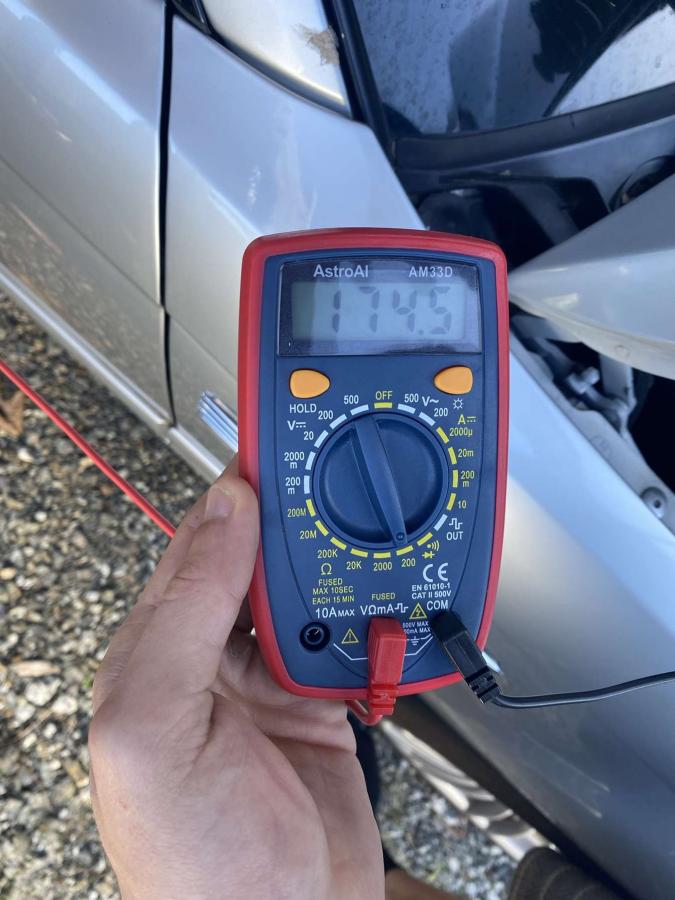

                        You're right I must have misread Bigjae's comment. I actually just re-measured the resistance from the negative lead to the jump post the way you said the the reading was 174.5ohms. False readings (caused by user error) seem to be a theme here lol.

                        So this would suggest the battery cable is bad? Presumably I'll need this: https://www.fcpeuro.com/products/bmw...12#description

                          That's the BST repair kit. Looks like wire from battery to firewall is 61122695530. Firewall to positive post in engine bay is 61136910539.
                          Past that there's the alternator wire too. You can isolate which section is bad by measuring each in isolation.
                          Edit: Just looked up prices of all these things. Funny how the entire wire is significantly cheaper than the patch in repair kit.

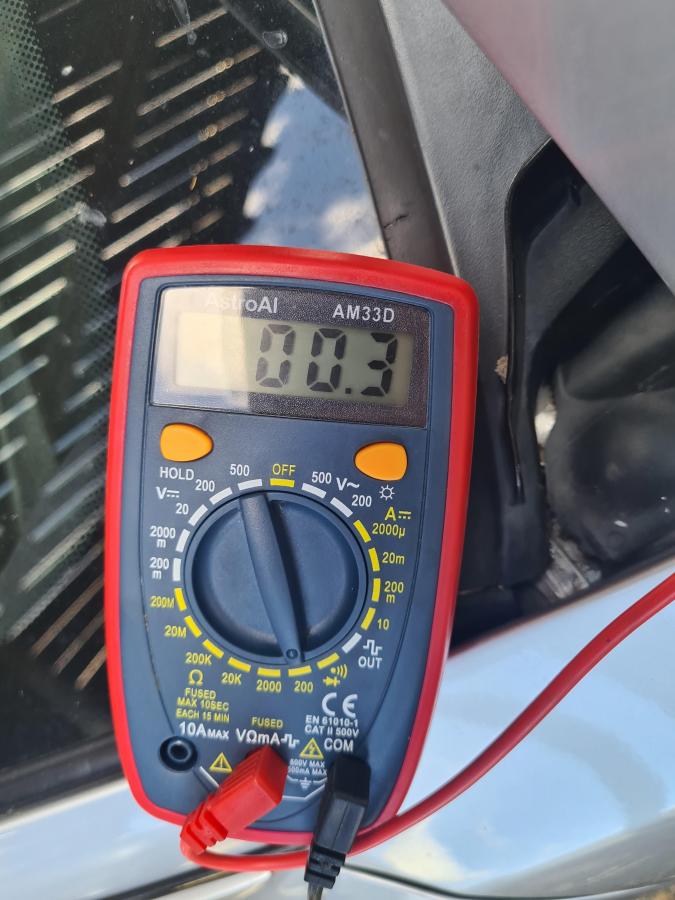

                            I also just retested cause I didn't trust myself and realised I had the multimeter hooked up to the negative lead. The actual reading from positive lead to jump post is 0.3 ohms, and the resistance from the multimeter is about 0.2 so the battery cable is fine. Lol, electrical stuff is definitely not my strong suit.

                            Tried to start the car yesterday with a fully charged battery reading 13.1v across the terminals and it didn't even start just cranked over a couple times. Voltage at the jump post fell below 8v while cranking so I think there has to be a bad ground somewhere.
                              Voltage at the jump post fell below 8v while cranking so I think there has to be a bad ground somewhere..
                              Where did you touch the voltmeter black lead? should be on the engine metal and not the chassis. Compare the reading (while cranking) when touching the black lead to chassis and to engine metal and if they are the same then the engine ground strap is good.
