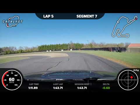

    Unsure why I didn't think of this earlier, but on my technique potentially being a problem: I do have a video from just yesterday at Summit Point Shenandoah. If anyone sees anything I'm doing wrong, braking or otherwise, super open to feedback:
          What tires are you on in the video and what size? A couple of corners you turn in abruptly and you could use more of the track width which would also help solve your turn in. Other than that it looks like a very good lap. How's understeer? Seems like the rear of your car is super stable.
            255/40R17 RS4s. I'll keep an eye out for that, thanks! Understeer is fine (I think). The rear can move around a little, and I am able to get some slip angle, but my confidence on Shenandoah isn't super high with all those walls really close by.

                You're not doing anything overtly wrong that can be seen on the vid - nice driving.

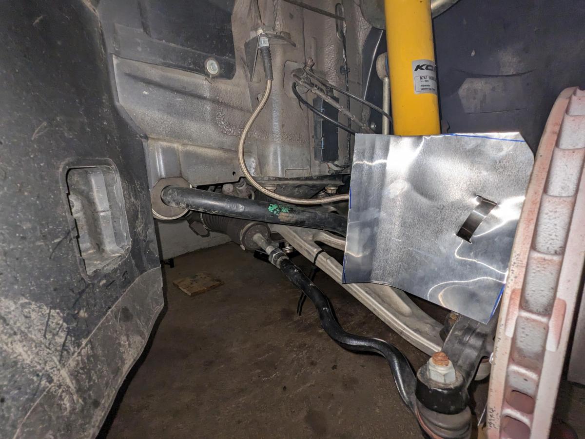

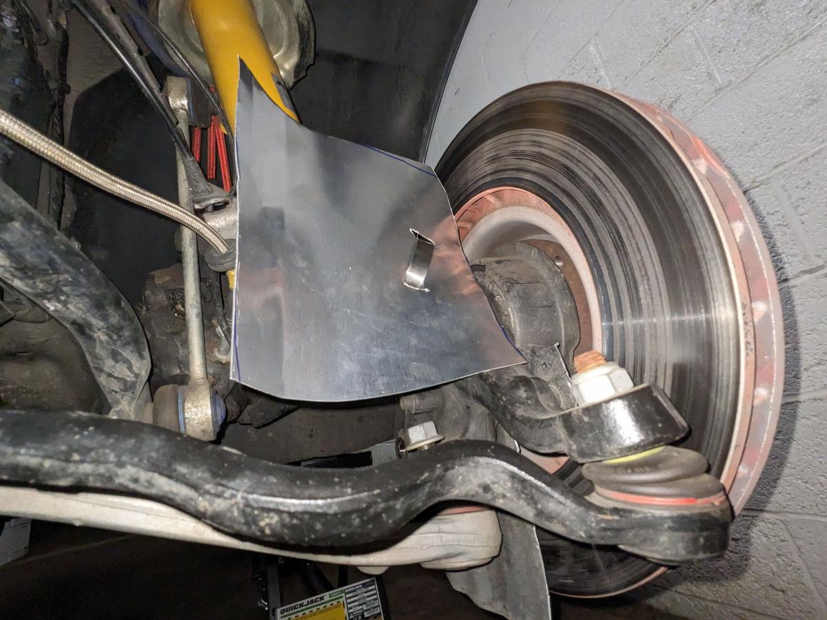

                            Played around with some sheet aluminum today, inspired by Vorshlag. Their plates are mounted to the control arm, but after doing some playing around, I actually think it makes more sense for the plate to be mounted to the knuckle. Here's how things sit right now. I think the plate can come down slightly, or at least should probably be trimmed on the top so it's not pushing air against the surface of the rotor. This setup is painfully simple, which gives me confidence in it not causing me problems on track, though we'll have to see how well that bend in the aluminum holds up at 130+.

                            Initial scientific aerodynamic testing performed by me blowing at the fog-light area with my spot blower has air pushing out of the rotor vanes that I can feel with my hand. Definitely didn't have that before this plate, so there should be at least some cooling improvement here!
                              Respectfully, your Shenandoah line and braking technique isn't optimal. From the video alone and without knowing your tires and not being in the right seat - your line is often early. This is tightening up your turns on an already twisty track. It 'appears' that you are braking earlier and longer than I would coach from the right seat. I only watched the video once, but if I was instructing with you, I would make you faster, and I think somewhat smoother. I don't know your tires, but it appears you are over-braking for T-11 and possibly T-20. With a different line in T-20 I think you'd be braking somewhat less. Possibly other turns as well. Your line in T-17 is the inside light car (Miata) line. Move left side tires (most of your grip) to the black patch in the center and you'll be faster. You may be able to brake more efficiently before the Karussel and release a bit earlier - but I'd need to be in-car.
                              Are you using an Instructor?
                                Appreciate these pointers! I've had very little instruction at Shenandoah, and wasn't being instructed in this video, so definitely have some to learn. Interesting on T11 and T17, what you're suggesting are things I played around with but found them slower when comparing using my Catalyst. What groups do you drive Shenandoah with? Would be great to get out there at the same time and talk shop.
