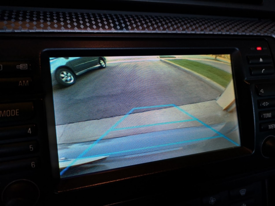

    ​​Oooooo, certainly enticing - I have the OEM TV tuner with my backup cam patched into it via a relay and triggered by the reverse light. Is there a way we can make this work without needing internal mods to the tuner?
    Click image for larger version  Name:	image.png Views:	0 Size:	898.1 KB ID:	212262 ​
      #32
      For stereo sound via the auxiliary mode, I would need to redo the relay for the reverse camera. Or if you aren’t too bothered about stereo sound (left and right channel), then the carplay can be done onto the AV channel.
      Either way, I would need to modify the tv tuner.
